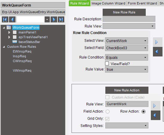

So, I have a Row Rule and I added code to change the background color to Orange instead of using one of the Setting Styles. Everything works fine except when I go back into the Customization screen. Every time I open it I get the following error.
Application Error
Exception caught in: mscorlib
Error Detail
Message: Length cannot be less than zero.
Parameter name: length
Program: CommonLanguageRuntimeLibrary
Method: Substring
Client Stack Trace
   at System.String.Substring(Int32 startIndex, Int32 length)
   at Ice.Lib.Customization.CustomCodeParseManager.ParseRuleActionCode(CustomizationLanguage custLanguage, String raCodeLine, RuleActionInfo raInfo)
Should I be concerned that this might cause an issue down the road? Everything compiles fine and the rows are highlighting orange. I just don’t want to mess up the system in some unknown way. Here is the code that (I think) is causing the error.

It’s when it’s trying to add it to the tree in customization mode. Remove the comments from that method and see what happens.
Still not working. I am going to try a Custom Action instead. I’ll report back.
This here is where I have seen things go sideways when you start messing with row rules manually. If going that route I don’t use the wizard at all to stop the parser from freaking out.

After fixing that, it compiles and runs as expected. Or does it always work when launching in developer mode, and only fails when that customization runs in normal mode?
It actually does not fail at all. Everything works and compiles fine. I was getting that error when I would do Tools-Customization.
