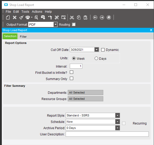

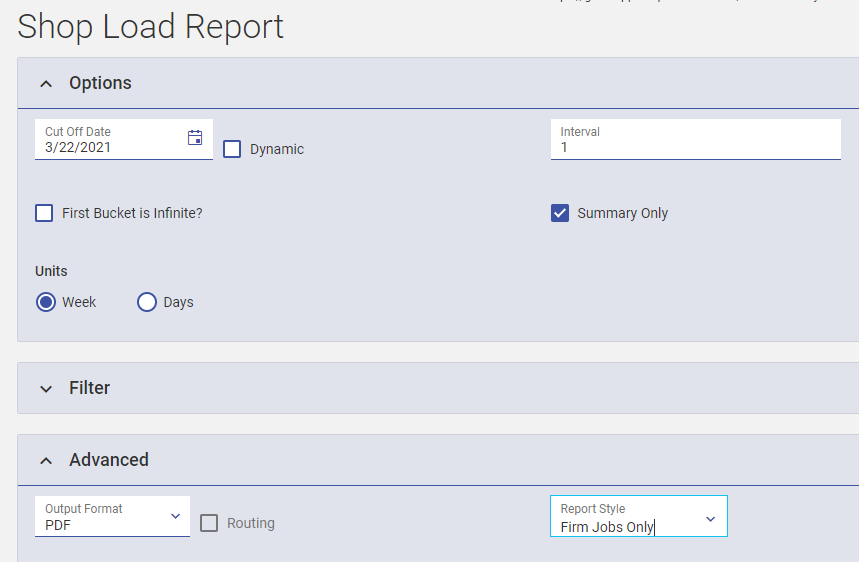

Shop Load Report Customization - Help Needed

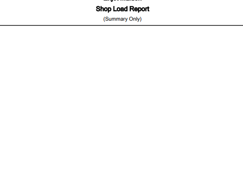

I created a report style which is a copy of the original report style and modified it to have a where statement that would filter out unfirm jobs. The issue I currently have is that when the end user selects “Summary Only” the report does not return anything.

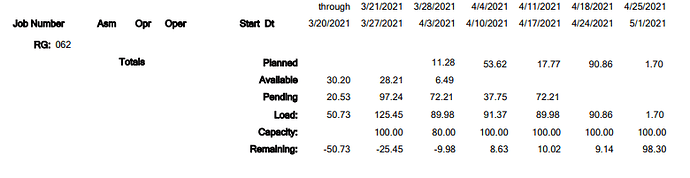

We had a customization written that separates unfirm jobs from the load, and also breaks the released load into “available” and “pending” hours.
Reach out to Com-Tec in Rochester, NY. They should have some code that meets your needs, how you go about getting that from them is up to you. It does work, though, and allows us to prepare data as shown below. You can use my name if you like to try to identify the custom code that they wrote for us.

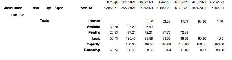

Hey, I’ve rebuilt my custom data set to make job head the primary table for this data to trickle down from and I have added a statement to the criteria for the table. This allows the summary and nonsummary versions of this report to run. The issue is that I am still getting unfirm jobs on this report. Any ideas?

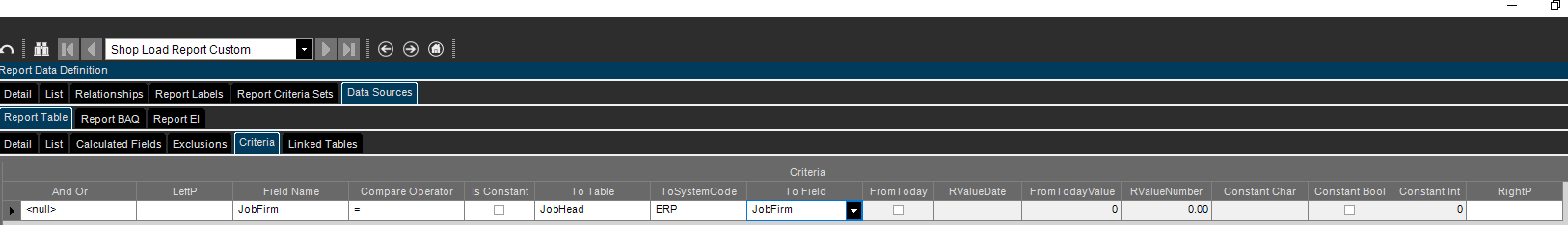

How do I go about filtering in the RDD? I believe I do it here, but I’m not seeing how to say that JobFirm =1.

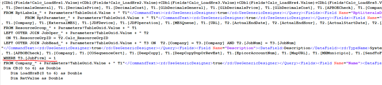

As for the query:
="SELECT T1.[Description],T1.JCDept,T1.ResourceGrpID,T1.Calc_WrkCtrCap1,T1.Calc_WrkCtrCap2,T1.Calc_WrkCtrCap3,T1.Calc_WrkCtrCap4,T1.Calc_WrkCtrCap5,T1.Calc_WrkCtrCap6,T1.Calc_WrkCtrCap7,T1.Calc_WCLoadHrs1,T1.Calc_WCLoadHrs2,T1.Calc_WCLoadHrs3,T1.Calc_WCLoadHrs4,T1.Calc_WCLoadHrs5,T1.Calc_WCLoadHrs6,T1.Calc_WCLoadHrs7,T1.JCDept_Description, T2.AssemblySeq,T2.JobNum,T2.OpCode,T2.OprSeq,T2.StartDate,T2.Calc_LoadHrs1,T2.Calc_LoadHrs2,T2.Calc_LoadHrs3,T2.Calc_LoadHrs4,T2.Calc_LoadHrs5,T2.Calc_LoadHrs6,T2.Calc_LoadHrs7,T2.Calc_PartNum,T2.Calc_ResourceGrpID
, T1.[Company], T1.[ExternalMES], T1.[JDFDevice], T1.[JDFOperation], T1.[MESQueue], T1.[URL], T2.[ActualEndDate], T2.[ActualEndHour], T2.[ActualStartDate], T2.[ActualStartHour], T2.[AttributeSetID], T2.[AutoSpcEnable], T2.[AutoSpcPeriod], T2.[AutoSpcSubgroup], T2.[ContractID], T2.[CurrentPkgCode], T2.[EstStdDescription], T2.[EstStdType], T2.[ExpCycTm], T2.[ExpGood], T2.[ExpPctUp], T2.[ExternalMESLastSync], T2.[ExternalMESSyncRequired], T2.[FSJobStatus], T2.[GeneralPlanInfo], T2.[Instructions], T2.[IsContiguous], T2.[JDFOpCompleted], T2.[LastPCIDPrinted], T2.[LastPrintedDate], T2.[MaterialColorRating], T2.[MiscInfo1], T2.[MiscInfo2], T2.[MobileOperation], T2.[NonProdLimit], T2.[PartQualEnable], T2.[PctReg], T2.[PlanningNumberOfPieces], T2.[PlanningRunQty], T2.[PrinterID], T2.[ProdUOM], T2.[QtyPerCycle], T2.[RemovedfromPlan], T2.[RequestMove], T2.[ReWork], T2.[SetupMaterial], T2.[SetupURL], T3.[JobFirm]
 FROM ResourceGroup_" + Parameters!TableGuid.Value + " T1
 LEFT OUTER JOIN JobOper_" + Parameters!TableGuid.Value + " T2
  ON T1.ResourceGrpID = T2.Calc_ResourceGrpID
 LEFT OUTER JOIN JobHead_" + Parameters!TableGuid.Value + " T3 ON  T3.[Company] = T2.[Company] AND T3.[JobNum] = T2.[JobNum]
where T3.[JobFirm] = 1
I’ve noticed that this query doesn’t represent what the RDD has in it and I believe that I just need to reassemble this to match what I’ve built in the RDD:

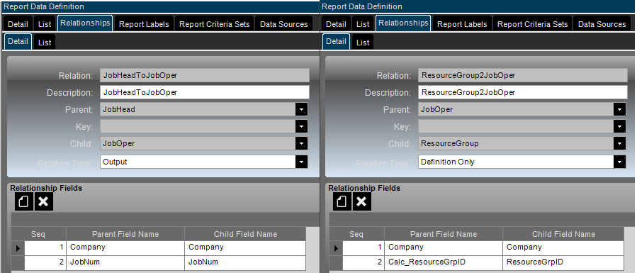

I have a few questions. I’ve run into an issue where I’m not quite sure what’s going on between the RDD and the report its self.
Let’s start with the original SSRS and RDD for ShopLoad. The RDD there has ResourceGroup as the primary table linked to JobOper by ResourceGrpID and Calc_ResourcegrpID. It also has company free floating as a table.
If I make a duplicate of that RDD and add in JobHead I would make the following changes:
  1. delete the ResourceGroup2JobOper relationship
  2. Create new relationship between JobHead and JobOper with JobHead as the parent, and it an output, and link it on company and jobnum
  3. Create new relationship between JobOper and ResourceGroup with JobOper as the parrent, def only, and link on company and resourcegrpid
  4. save and link it to my duplicate of the original ShopLoad SSRS report.
  5. create a table criteria for jobhead on JobFirm true (this should filter my report from top to bottom to remove all unfirm jobs and their time from my report)
From there I would go into the query on the ssrs report and change the following:
  1. Make JobHead table 1
  2. make resourcegroup table 3
  3. change all table assignments to reflect these changes
  4. change all links in the ssrs to reflect this
When all changes are made and reupload to epicor the ssrs should now reflect what is in the rdd and should work perfectly in my mind. Issue is that I am either missing a step or epicor doesnt like drastic changes to SSRS queries, and I receive a generic error message stating that there is a problem with the report.
Is there a better way of accomplishing this than the steps I have listed?
To fix your criteria, you would want to make sure you tick the IsConstant box. Then put the number 1 to signify its equal to true
