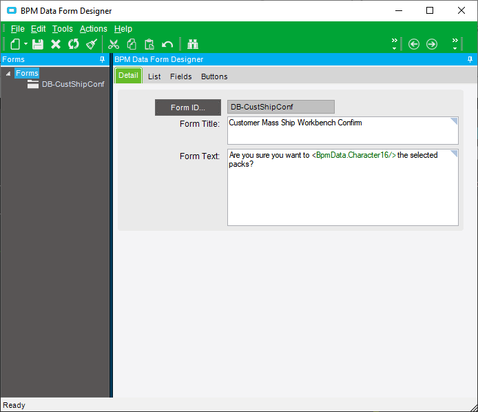

Few options:
  1. Customization Layer listening to the BeforeAdapter Event (Unsure what it is in Kinetic, but works in Classic).
  2. Pre BPM that Invokes a Simple Yes/No BPM Form and based on that result you can throw an exception to stop the BPM (should work on Kinetic as-is).
  3. You may be able to use one of the outMessage parameters, but more difficult.
If I want Kinetic readiness, id go with #2. It may not be the prettiest but it’ll do. You can change the label on the buttons.
