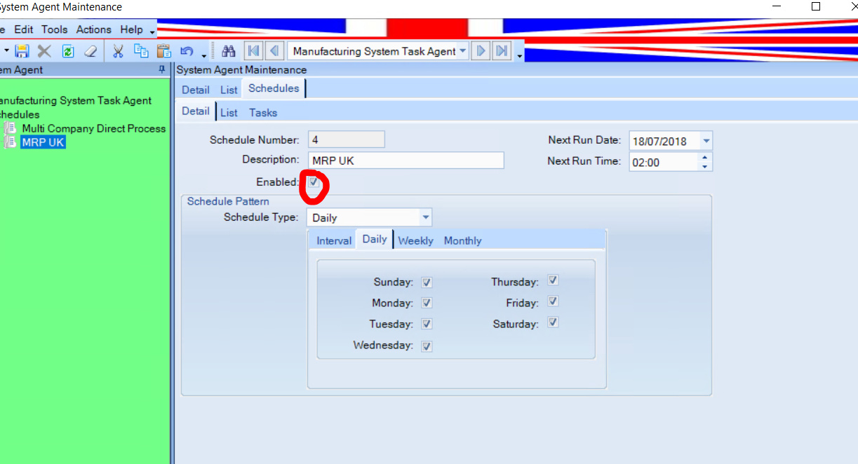

I was asked to MRP back on a schedule…i thought it should be as simple as ticking the “enabled” box, but nothing happened…i then noticed there wasn’t any task details behind it…is this the problem and if so, what should be entered here?

I went to system agent and created a new schedule called MRP UK 2.
Added a next run date of tomorrow with time of 2am.
Set it daily from Monday to Friday and ensured the enabled tickbox was ticked.

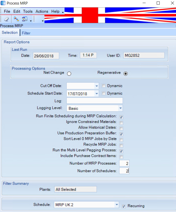

Went to the Process MRP function and the schedule was there at the bottom in the dropdown box…i selected it and changed the settings to the below screenshot.
Clicked actions / save defaults
Clicked tools / save layouts.
Clicked process
Then “process submitted” appeared at the bottom of the screen.
Went back to the system agent and realised that now a task has been generated behind the new schedule.

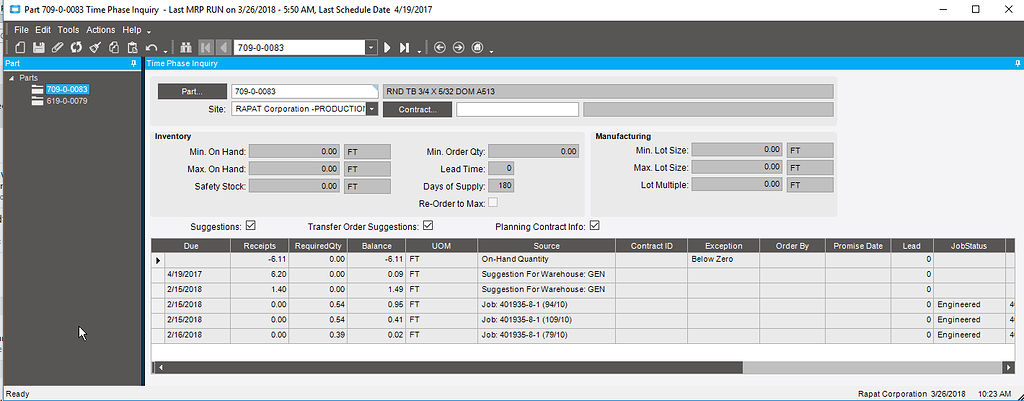

I think that’ll do it for you. I noticed you do not have Dynamic checked on Schedule start date. We have found this useful so that the MRP isn’t always showing SS due dates in the past where there are immediate needs for part. See this post from before for what that looks like to user:
nancy
I agree with Nancy it is best to Set the start date to Dynamic so you don’t get any past dates.
