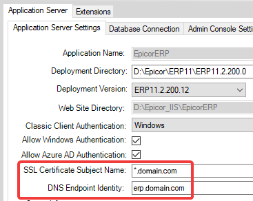

Yes, this is possible. We don’t expose our system to the internet, but internally our DNS is set up with a CNAME record that points to our Epicor app server. You need to set up your app server’s DNS Endpoint Identity, and have an SSL certificate for the domain (we use a wildcard SSL cert to cover multiple subdomains).
