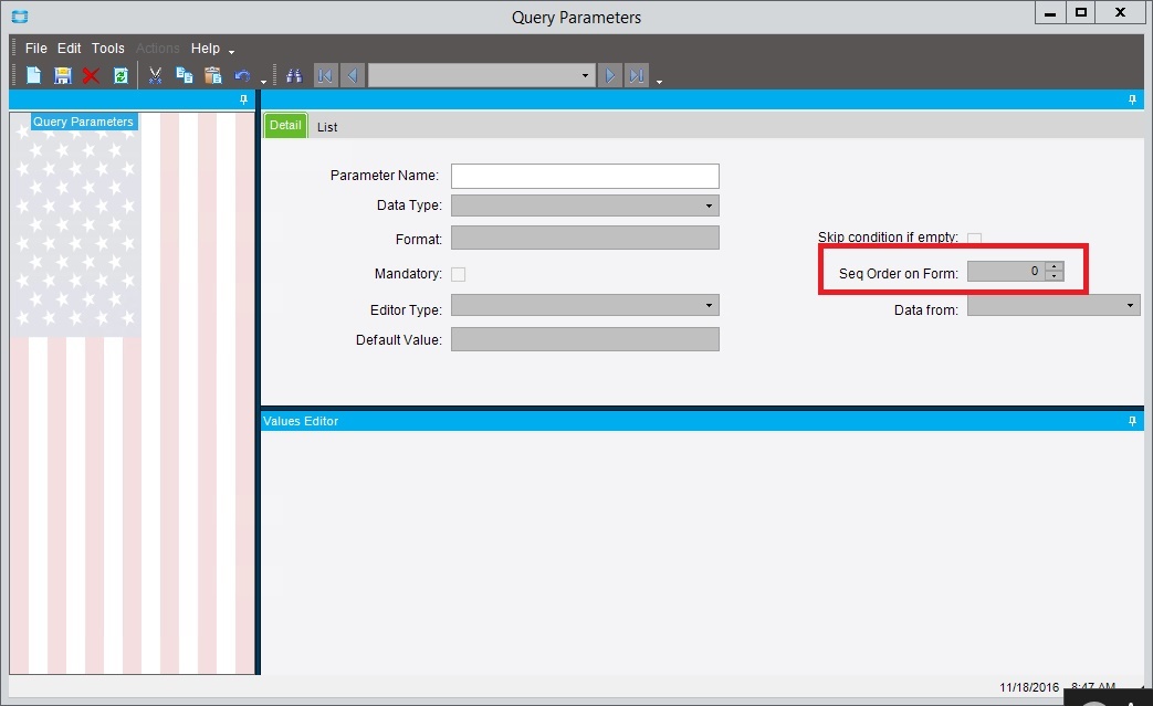

At least in E10.1, there’s a setting to control the display sequence. See attached.
Fantastic. We are still on 10.0.700.4, upgrading soon. I will look for that once installed. Thank you
