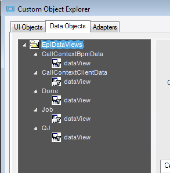

I don’t see anything under “Data Objects” besides “EpiDataViews” which doesn’t seem to expand into anything containing a resemblance to the UI field I want to initialize.
try expanding the dataView
Oh wow, how did I miss that… twice? :sweat_smile:
@ckrusen Haha I see how I missed it: It doesn’t always show up! I had to click on the item this time before I saw it:

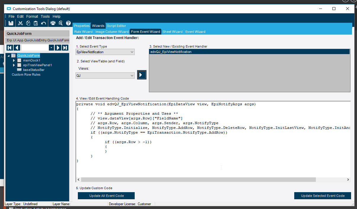

Also, this is something that you need to put in an event. You can’t just put in in initialize custom code.
Check out the even wizard for epiview notification. You put you code in the brackets in the if statement.
So if you use the wizard for that, you can use the code example from the wizard in the comments.
view.dataView[args.Row]["FieldName"]
Change “FieldName” to the field name that you found in the object explorer.
so you end up with this
	private void edvQJ_EpiViewNotification(EpiDataView view, EpiNotifyArgs args)
		if ((args.NotifyType == EpiTransaction.NotifyType.AddRow))
			if ((args.Row > -1))
				view.dataView[args.Row]["WarehouseCode"]= "GEN";
So whenever there is a new row, it will set this to your warehouse.
