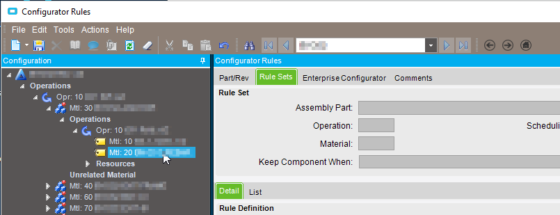

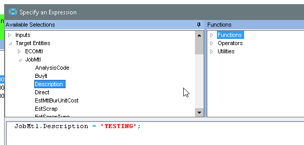

Actually you can set a materials description (or practically any other field)
In Configurator Rules,
  1. Select the material
  2. Create a Rule Set, with Keep when expression return true;
  3. Create a Rule, with condition Always Execute
  4. Create an action, of type “Execute Specified Expression”
  5. In the Expression editor:
