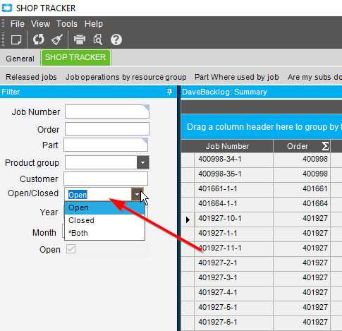

if the options that you want to filter by are a specific list, I usually add a drop down list. It will default the whatever is first in the list. Then auto load would load it. The example below I created a calculated field that looks at open and if open has a value of OpenBoth, and if Closed, ClosedBoth. The * in front of Both acts as the wild card so that a begins with filter will work for that. (another user here came up with that trick and I stole it because it was brilliant)

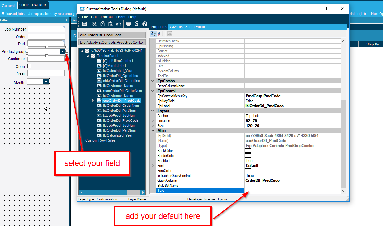

You can try to add the default text in the properties under customize tracker view. I have gotten some things to stick before, however, it has not been consistent for me. You might have to do a customization with code to force populate the field. (maybe other can help with that code, I’m a copy and paste guy when it comes to code) Probably on form load, don’t use the auto refresh, then set the customization to run after load so you can populate the field first before getting all of the data, and then force a refresh with code so it acts like auto refresh. I wish I had better guidance on the technical part of it, but I’m still learning too.

An example from another source I found but couldn’t get to work was:
private void MainController_Load(object sender, EventArgs args) {
var txt = csm.GetNativeControlReference(“1685c535-de49-43f5-88ed-12cefa5a9bc3”);
txt.Text = “CURRENT”;
After deploying with auto refresh on, I added to menu as ‘Dashboard-Assembly’ and customized it.
I added to the Script editor and changed the GUID in the code to the dropdown’s GUID and the text to ‘CURRENT’.
Saved and did a test. Didn’t seem to work.
The error it gave me was: Exception has been thrown by the target of an invocation.
