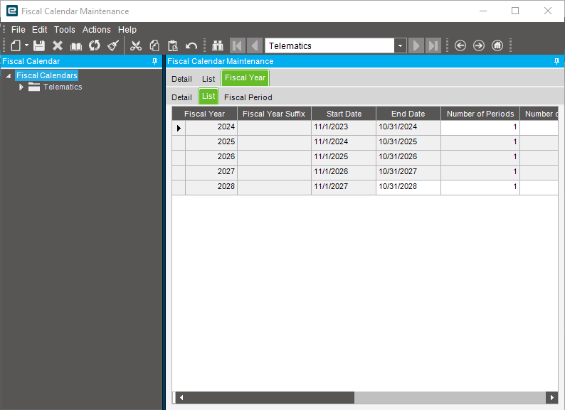

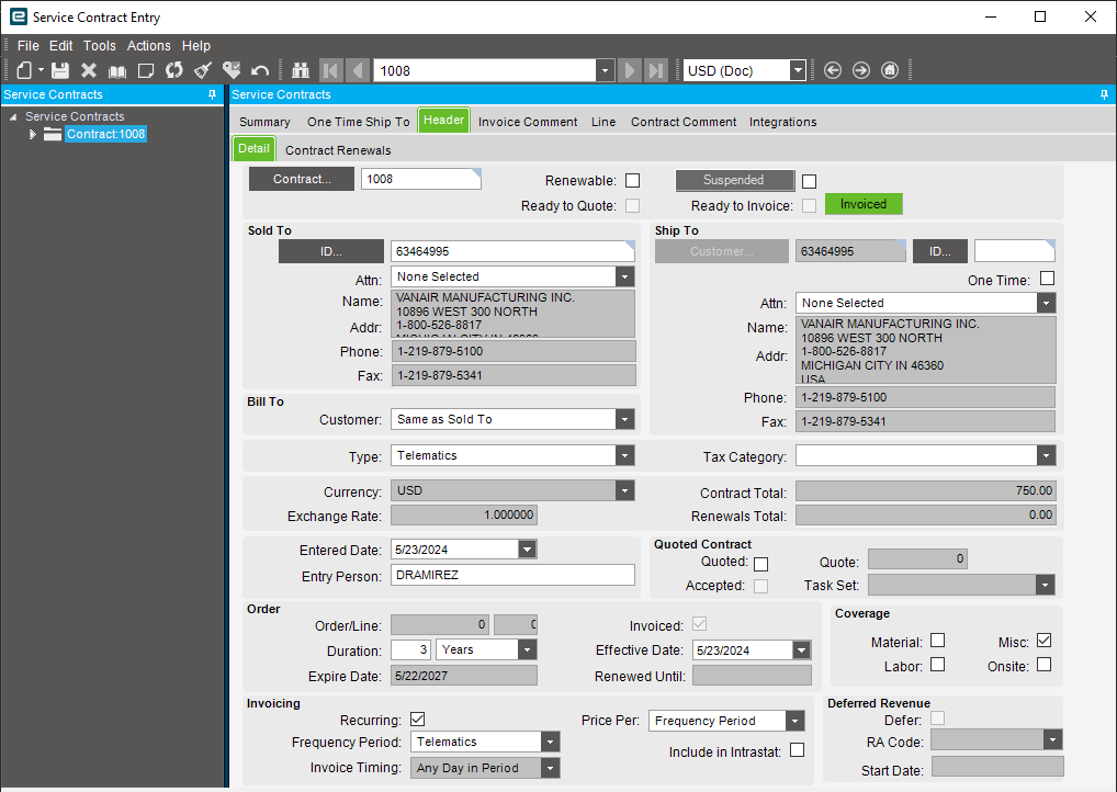

If I check the recurring box on Service Contract Entry, I can’t seem to get recurring invoices to work. Is there a trick to it? I’m struggling by trial and error. The Documentation doesn’t really say much about this. I would’ve thought that it would check the Recurring box on Invoice Header in AR Invoice Entry… but it doesn’t. How is it supposed to work? I have a contract length of 3 years. I have a fiscal calendar defined with 1 period per year. That’s what I’m selecting for the frequency period. I get the initial invoice to generate using Get Contract Billing. But I can’t get subsequent invoices to generate using Generate Recurring Invoices.

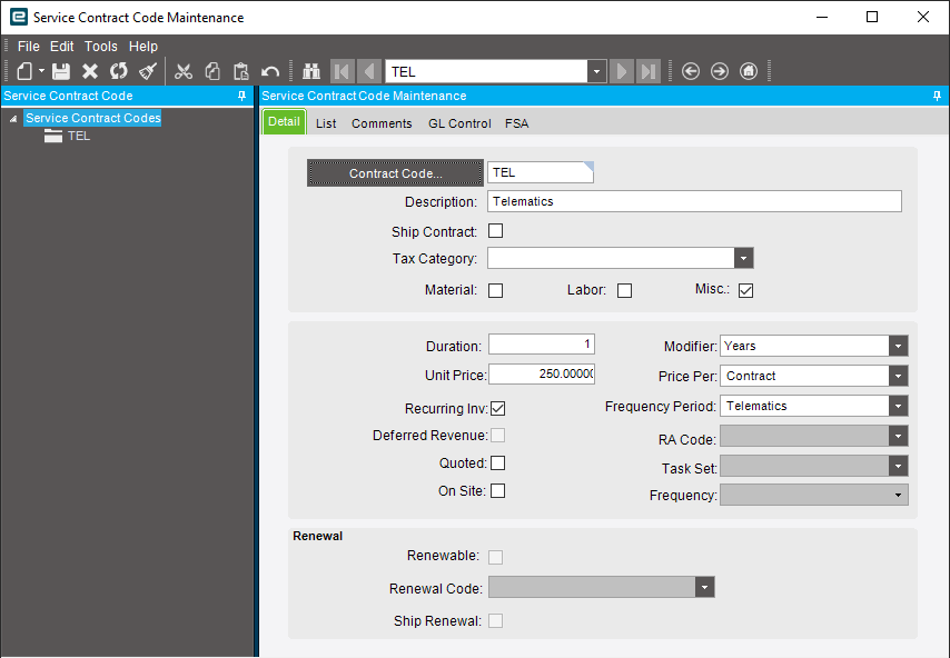

I want to create a contract for a subscription service. We install telematics on work trucks. Our intent is to charge our customers an annual subscription. Ideally, we’d create the contract once and then it would continue in perpetuity until the customer cancelled it. Ideally, we wouldn’t have to touch it after it was started (other than to periodically generate an invoice). So my thought was to create a contract with a duration of say 99 years that has a recurring invoice that has a billing frequency of once per year. So I created a fiscal calendar for this that has 1 period per fiscal year. If there’s a better way, I’m completely open to suggestion.
So there’s no confusion, there are qty 3 on the contract line which is why the total is 750. It’s 250 * qty 3. It should be 750 per year for 3 years. I get the initial invoice of 750. If I create an AR Group and date it out a year from now, I don’t get any recurring invoices to generate.
