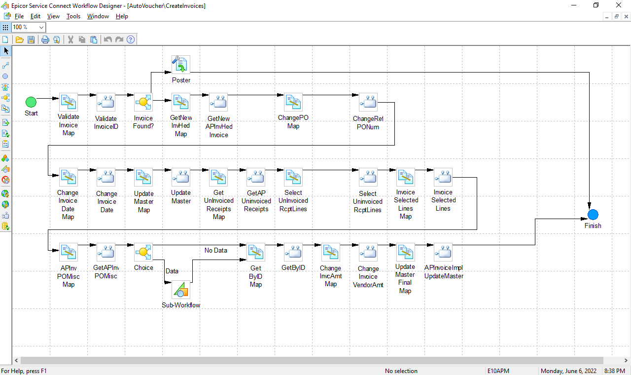

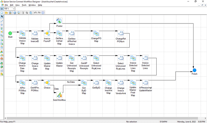

First, I’d like to say that I’ve built numerous Service Connect workflows and 95% of them were massive PITAs to troubleshoot through the process of building them. They really need to work on their error logging. That being said I’m working on a workflow that creates AP Invoices. Everything has gone smoothly(ish) up until now. I’ve managed to have my workflow create the group, the header, and any non PO invoice line, and PO invoice lines that have not been received. The problem comes when trying to invoice Receipts. I get an “Invalid Uninvoiced Receipt” error on the SelectUninvoicedRcptLines BO. I’ve ran through the manual trace and literally every field matches up with the SC return. Has anyone run into this and managed to find a solution?
This is the workflow we use

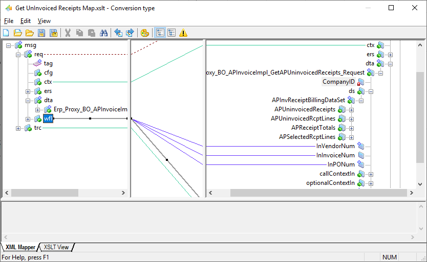

Was there anything out of the ordinary that you had to during the conversion between GetAPUninvoicedReceipts and SelectUninvoicedRcptLines?
Forgive me but it has been many years since this was created,
In the conversion all fields are mapped across except SelectLine is set to true and RowMod is set to U in the APUninvoicedRcptLines table (for the current vendor invoice)
And RowMod set to U in the APUnivoicedReceipts table
I’m sorry to bother you again but I’ve been trying just about everything I can think of for the past 2 days to get past this one part with 0 luck. In your conversion between your UpdateMaster and GetAPUninvoicedRcptLines did you provide anything to the request other than CompanyID, InVendonNum, InInvoiceNum, and InPONum? I’m trying to work backwards at this point to see if I’ve left something out along the way to the SelectUninvoicedRcptLines. Thank you very much for your help.
That is all I have mapped there

<ext_APInvReceiptBilling:CheckBox01>false</ext_APInvReceiptBilling:CheckBox01>
<ext_APInvReceiptBilling:UD_SysRevID>AAAAACp9mJI=</ext_APInvReceiptBilling:UD_SysRevID>
</ext_APInvReceiptBilling:APUninvoicedRcptLines>
<ext_APInvReceiptBilling:APReceiptTotals>
<ext_APInvReceiptBilling:CurrencyCode>USD</ext_APInvReceiptBilling:CurrencyCode>
<ext_APInvReceiptBilling:AvailableTotal>34305.830</ext_APInvReceiptBilling:AvailableTotal>
<ext_APInvReceiptBilling:Company>BWF</ext_APInvReceiptBilling:Company>
<ext_APInvReceiptBilling:DocAvailableTotal>34305.830</ext_APInvReceiptBilling:DocAvailableTotal>
<ext_APInvReceiptBilling:DocSelectedTotal>0</ext_APInvReceiptBilling:DocSelectedTotal>
<ext_APInvReceiptBilling:InvoiceNum>TestInvoice</ext_APInvReceiptBilling:InvoiceNum>
<ext_APInvReceiptBilling:Rpt1AvailableTotal>0</ext_APInvReceiptBilling:Rpt1AvailableTotal>
<ext_APInvReceiptBilling:Rpt1SelectedTotal>0</ext_APInvReceiptBilling:Rpt1SelectedTotal>
<ext_APInvReceiptBilling:Rpt2AvailableTotal>0</ext_APInvReceiptBilling:Rpt2AvailableTotal>
<ext_APInvReceiptBilling:Rpt2SelectedTotal>0</ext_APInvReceiptBilling:Rpt2SelectedTotal>
<ext_APInvReceiptBilling:Rpt3AvailableTotal>0</ext_APInvReceiptBilling:Rpt3AvailableTotal>
<ext_APInvReceiptBilling:Rpt3SelectedTotal>0</ext_APInvReceiptBilling:Rpt3SelectedTotal>
<ext_APInvReceiptBilling:SelectedTotal>0</ext_APInvReceiptBilling:SelectedTotal>
<ext_APInvReceiptBilling:VendorNum>82</ext_APInvReceiptBilling:VendorNum>
<ext_APInvReceiptBilling:SysRowID>00000000-0000-0000-0000-000000000000</ext_APInvReceiptBilling:SysRowID>
<ext_APInvReceiptBilling:RowMod>U</ext_APInvReceiptBilling:RowMod>
</ext_APInvReceiptBilling:APReceiptTotals>
</ext_APInvReceiptBilling:APInvReceiptBillingDataSet>
</ext_Erp_Proxy_BO_APInvoiceImpl_SelectUninvoicedRcptLines_Request:ds>
</ext_Erp_Proxy_BO_APInvoiceImpl_SelectUninvoicedRcptLines_Request:Erp_Proxy_BO_APInvoiceImpl_SelectUninvoicedRcptLines_Request>
</msg:dta>
Anything in the Epicor Server event logs?
Anything different from the error message in the tracking in the Service Connect logs?
We are on 10.2.500.9 BTW
