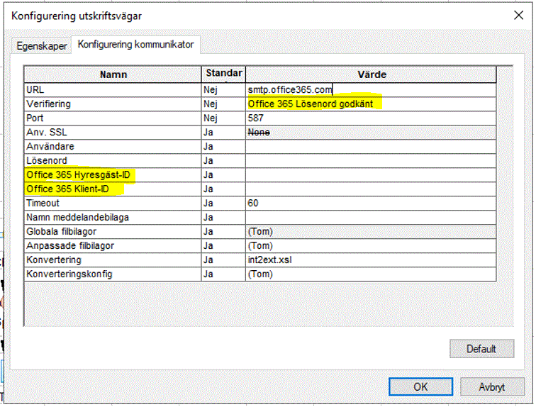

I have found the news about it but no information how to set it up. Is there any “best-practise” from Epicor how to do it the best way in Service Connect and Office365 (Microsoft365).

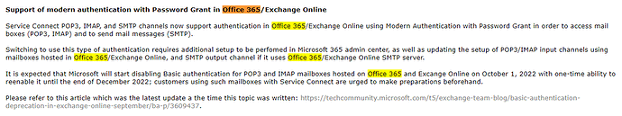

There is a topic in Service Connect and iScala help called “Setting up mail channels to use Office 365/Exchange Online Modern Authentication with Password Grant” that describes the process; descriptions of POP3/IMAP/SMTP channel settings in the help have the new settings described and also link to that topic.
When copying guids from Office 365 portal to channel settings for applicationID and clientID, please make sure you do not include linebreak characters in the pasted values, as that breaks the authentication.
