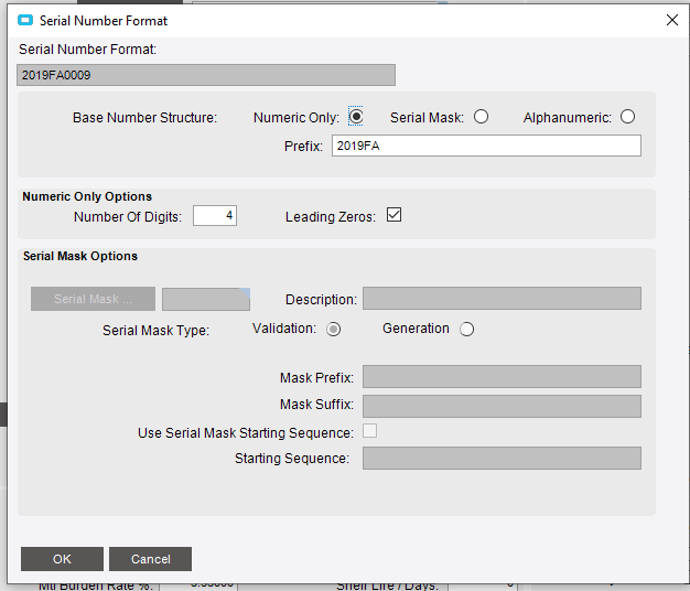

I don’t think we have things set up properly in our system. Currently at each part they are tracking serial numbers they have the S/N Format set up for the following
And I can change the prefix to say 2020FA but the parts are still getting assigned as 2019FA.
I thought maybe we set this up wrong and needed to do it by a mask but I can’t get it to look right on the mask maintenance under the example
I don’t think the prefix is stored with the S/N, when you have Numeric Only selected.

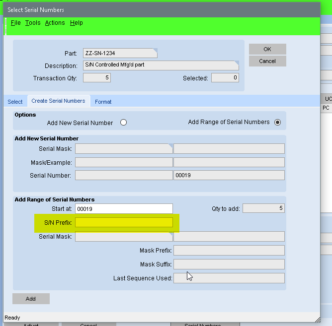

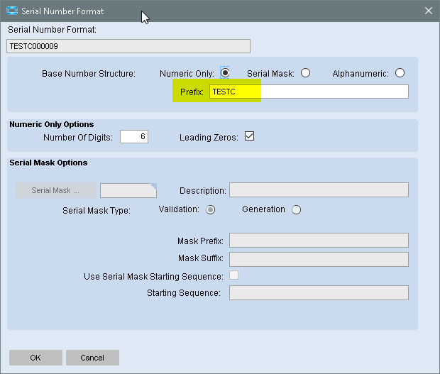

After creating the S/N’s (via the Qty Adj), I go pack to the parts and enter a S/N Prefix and save.
Using Qty Adj Again, the Add Range of Serial Numbers still show no Prefix

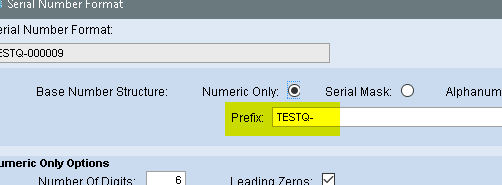

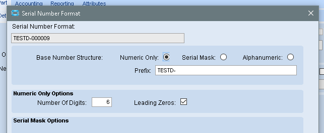

Making a new P/N (actually just duplictaed the test part), and setting the Prefix before any S/N’s are generated:

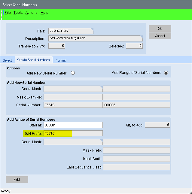

Then during the Qty Adj I see:

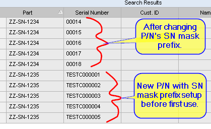

After the Qty Adj is processed, the new Part’s S/N’s do include the prefix

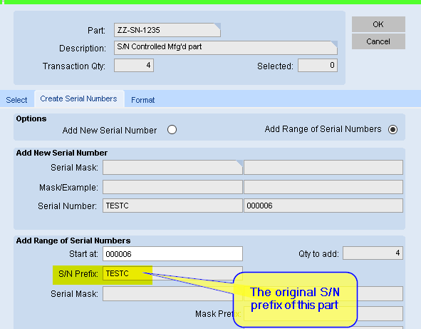

And after changing the prefix of the new part,
the S/N’s still want to use the old prefix.

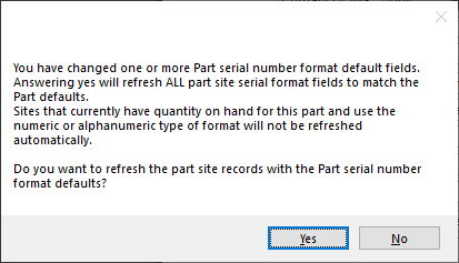

In our case we make sure we get this message when we save.
