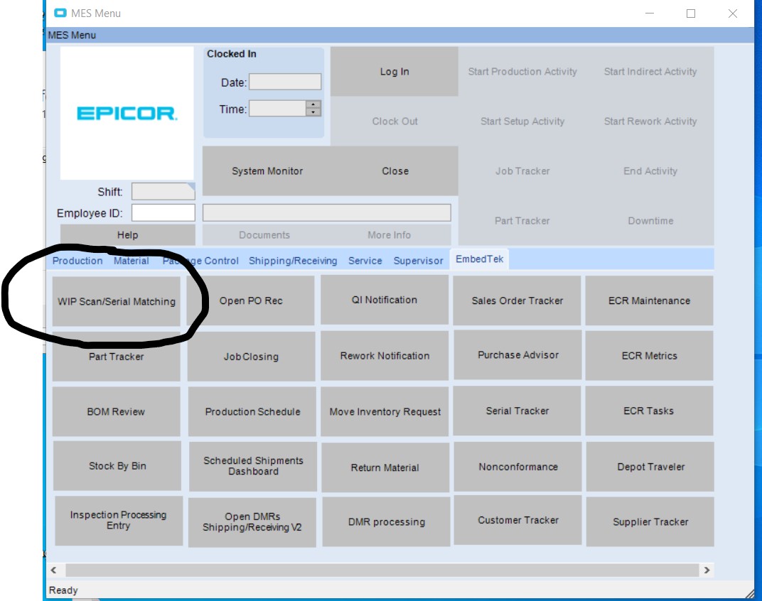

I know late to the party. We have created a custom screen to do just this. It has saved us money as we have reduced the need for full clients. If interested I can share what we did in more depth. The screen is tailored to our process where we scan in the parent barcode, then scan the components of the build when they are assembled. Just saying as our process may not fit yours, but the matching part may help.
Yes please! it would help
Here is a screen shot. The user enters the parent SN. Then can scan all the component parts. There is validation to make sure that the Component SN being scanned is Available to match as well. Folks can also unmatch here as well. The Banner even changes to Full Matched and Green when fully matched.
Awesome and this is a custom module added to MES?
we use this process with multi level S/N Matching in and out. there must be a BPM used here?
No BPMs yet this is all custom code. We are moving to using BPMs by loading an ud table.
