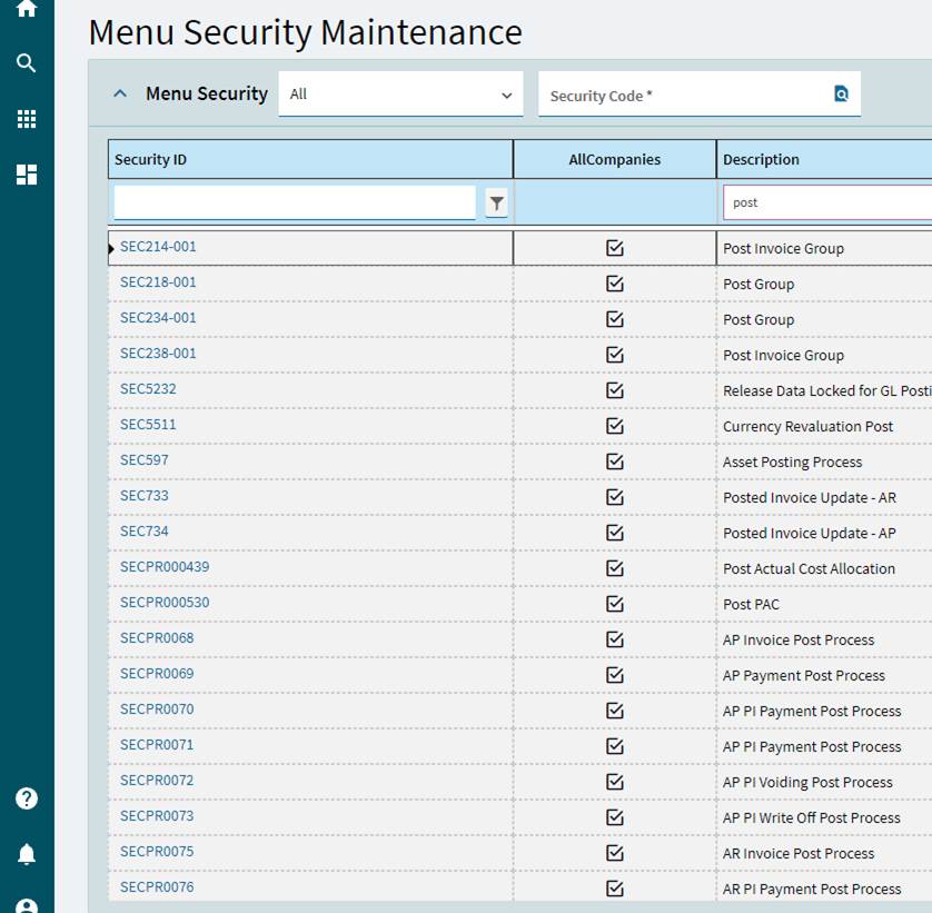

I believe you could use Menu Security for the purpose. There are some Security IDs for Post process as under:
