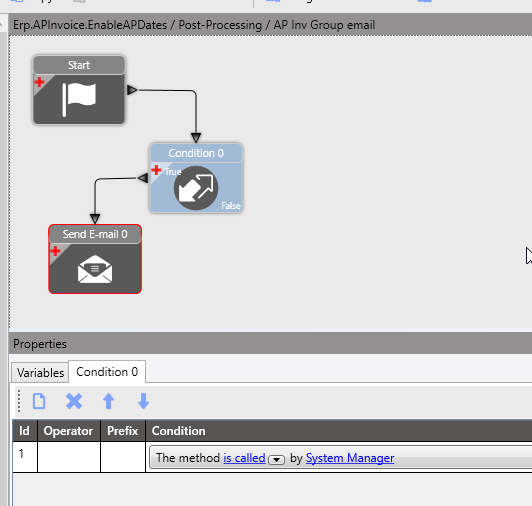

a BPM on one of the BO calls that happen the specific form loads, is your best bet.
For example, AP Invoice Entry first calls APInvoice.EnableAPDates. So a Post Proc BPM on that could send an email that would include the userid.
I am aware of that, and unfortunately there is not a great way to do this that cannot be bypassed due to there not being a lot of granularity to the security of the security manager. Having said that, I wanted a solution where someone would have to go out of their way to do this. Such as turning off bpms, menu security, or customizations.
Fairly easy. But requires doing it for every form. If you’re lucky some forms may call the same BO methods, so that BPM would fire on those as well.

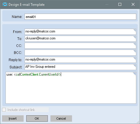

and the email widget like:
A potential downside is that when other forms or processes call the BO, it will fire. Not sure how to limit it to a specific form calling it.
