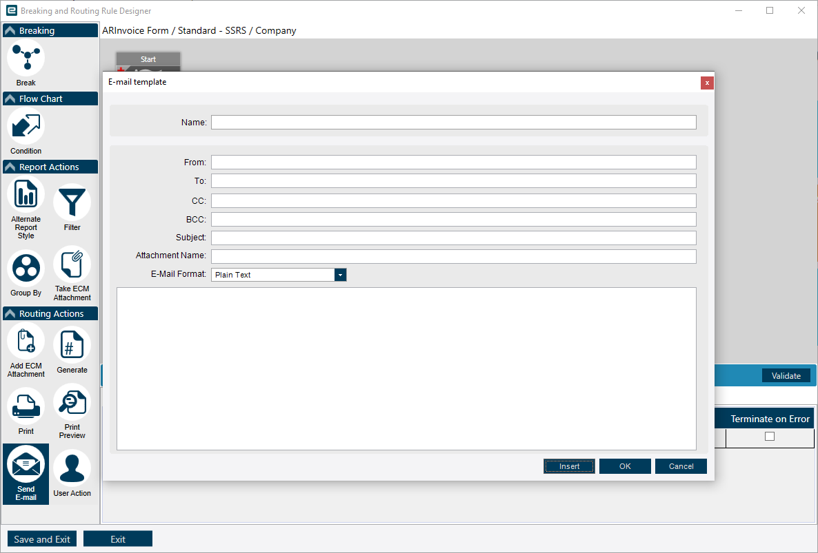

Well, the easy answer here would be use Advanced Print Routing… if you own it.
Otherwise, you could try and hook into the report’s SubmitToAgent method and inject the email there. Downside is each report has its own.
Correct me if I’m wrong, but doesn’t APR still use the mail configuration set in the company settings? I think you can spoof the “from” email in APR but the actual server is the same
I guess I’ve never really verified it, but you can set a “From” email address. I just assumed it would show up in the email box from that address?
Correct. I’m probably overthinking the question now that I see what they are asking lol
  1. If you leave From Blank it will pull from Company Settings
  2. If you fill out the from with something@yourdomain.com it will use that (spoof via smtp)
  3. If you want to get the Users Email (APR isnt build for that), you will have to modify your RDD (Report Data Definition and join on the table UserFile based on lets say InvcHead.SalesRepEmail_c or something like ChangedBy

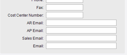

So instead of messing with RDDs because you can very quickly destroy your ARForm RDD by adding a bunch of metadata joins. What most people do is they add fields to the Company Table such as:
  • Company.SalesEmailAddr_c
  • Company.AREmailAddr_c
  • Company.APEmailAddr_c
Because Company is a table that is ALREADY in 99.9% of RDDs, they simply include it and viola, no joins. But then the email comes atleast from lets say accounting@yourdomain.com.
In more simpler terms there is no way to get like Session or CurrentUserEmailAddr easily in Routing.

I’d really recommend looking into it, it’s a great little add on that makes stuff like this trivial.
It turns out we do have APR, and I was able to do what I wanted to do.
