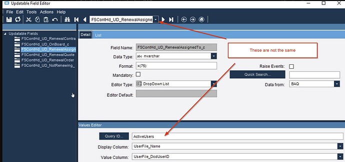

Inside the Updateable BAQ, you can set the properties for editable fields using Advanced Column Editor Configuration.
Once there, you can pick the field and change the Editor Type to dropdown list, and set where the values come from.
It’s a bit odd when working in Dashboard Configuration in that you have to fiddle around with the column width some since the value when editing is not the same as the display value when you run it. (in my example, userid shows when editing vs user name when running)

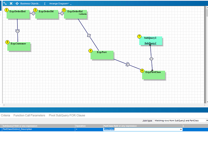

I’ve tried this but it still returns multiple values, I did it as an inner subquery as I get failures trying to doing Top Level, does it need to be Top Level please?
Show some screen shots of what you are doing. Your drop down should be showing what’s exactly coming out of your BAQ. To it’s most likely just a problem with your BAQ, but without see what you are doing, that’s just a guess.

Created SubQuery2 – Distinct Part Classes
Joining into Main Query using the description field in this example, but have also tried joining on ClassID
Then make the Part Class description field updateable in BAQ to enable drop-down function but I’ve mapped it to the subquery Distinct Part Class field.
Pulling this into the dashboard, still gives me multiple duplicates as it’s still linking to main query so it seems to be bringing through part class descriptions for every release
I can’t see the titles to know this for sure, but it looks like you are referencing the same query that you are trying to get the drop down in?
You’re supposed to make a totally different query for the lookup in the drop down. Your lookup query just needs the bare minimum to get the list of things that you want to see, with an ID field and a display field, (which may or may not be the same thing depending on what you are filling in).
