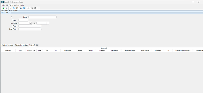

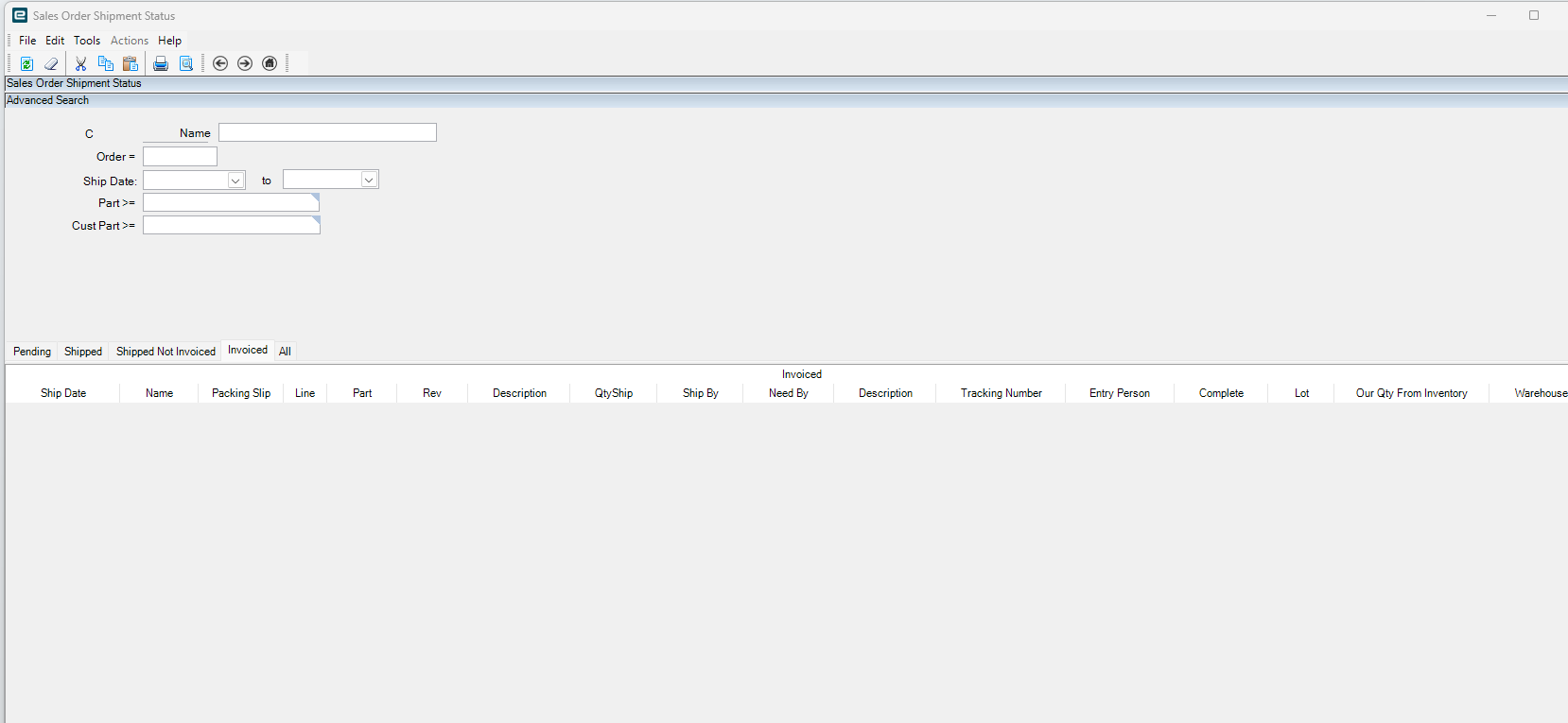

The Sales Order Shipment Status screen does not look right on one of my employees screen. She tried taking it off of her favorite and adding it back on and it still doesn’t work. She also has tried going to personalization and delete on bottom. It works until she opens it up again it then goes back to looking weird. Here is a screen shot of it.
After deleting the personalization, are they saving the layout?
Ms. Tanya: Try having her login to a different PC and see if the layout looks correct.
If it looks correct, you may want to try a full client cache delete. i.e. c:\ProgramFiles\ProgramData\Epicor. . . and C:\Users<username>\AppData\Local\Epicor . . .
