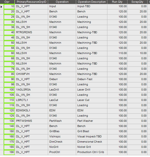

We are having an issue with a job not taking into account the scrap % through the entire job. The job is for 100 finished pieces and has multiple operations with a scrap % of 10 or 20%. For this job, we will scrap 110 pieces to meet the demand of 100 pieces. However, Epicor is not telling us that we need to input 210 pieces to account for the scrap accumulatively.
Any idea how I can account for the scrap % through the entire job?
Entering the scrap in job entry is not an option for us because we have multiple people and departments entering jobs in Epicor.
You will need to do the “math” for each operation and adjust the scrap % for each operation. Epicor does NOT (unless solved in latest version which I have not tested yet) have the logic to add multiple operation scrap % values together so that the first operation is overproducing enough to account for all the scrap factors.
