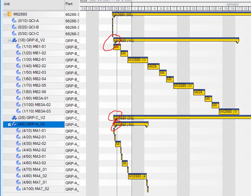

We are in
This is how it should look

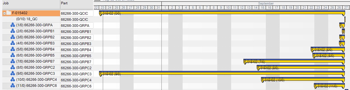

This is how it’s currently looking.

Operations in the main assembly are set start to start where it’s applicable. The subassemblies are in the finish to start within their operation trees as those operations should be sequenced that way.
