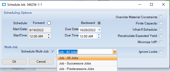

I rescheduled a job that was already released and scheduled, by going to Job Entry > Actions > Schedule > Job Scheduling…
When I reschedule a job this way, do I need to run global scheduling to see the changes to the schedule for other jobs? Or does rescheduling the job move the other jobs around as needed?
In my example, I have a job that is not due until January 2023. I want to bring that job forward and run it sooner. So I rescheduled the job to forward schedule from the date I want to start the job on. Is this enough to update the schedule, or will global scheduling need to be run?
Thanks!
Nate
Hi Nate,
Unless you are using make to job on these and you do the Schedule Multi Job, I believe you need to run the global scheduling.
Nancy
