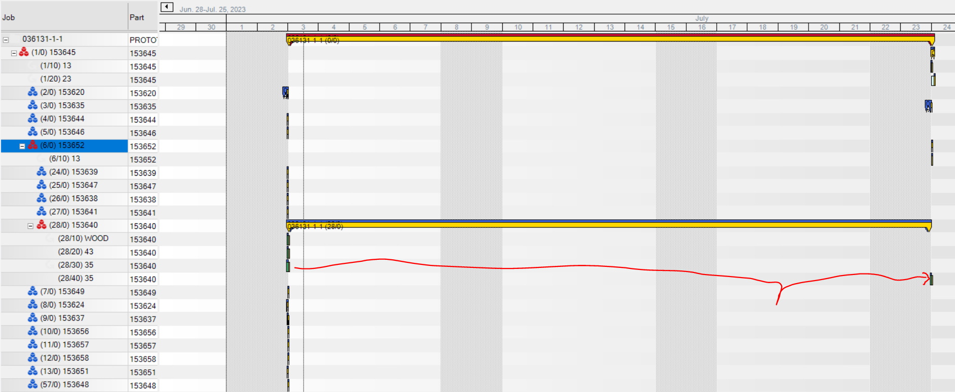

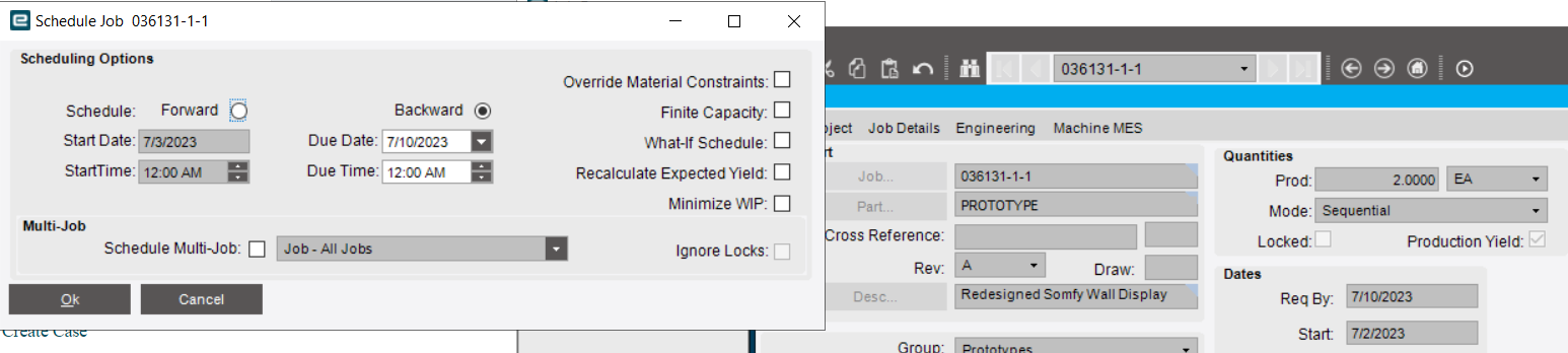

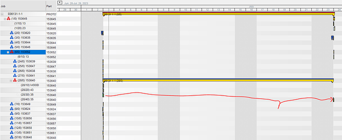

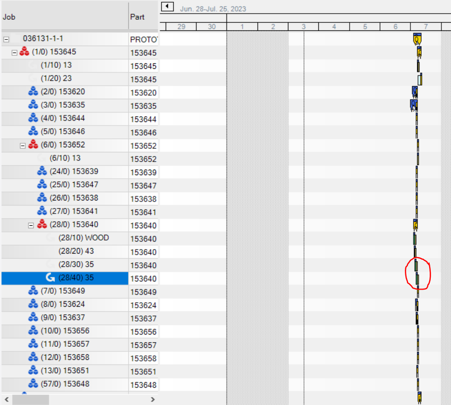

I have scheduled a job (Job Number 036131-1-1) and I backward scheduled it and it is due 7/10/2023. I have not checked override material constraints and no check on finite schedule.
It results in the job being scheduled as shown. It puts 20 days between the stencil operations on Asm 28, operations 30 and 40.
I am trying to figure out why the big gap between the operations. If I reschedule the job and check mark the override material constraints then the job finishes on July 6 and there are no gaps between the stencil operations.

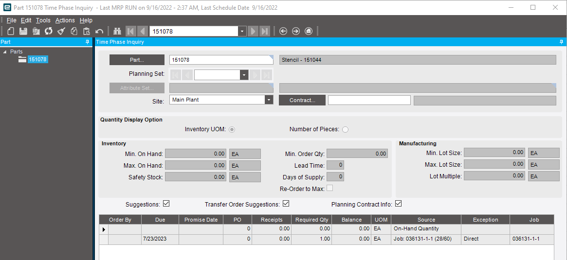

What do you have for open POs for 151078?
Hi,

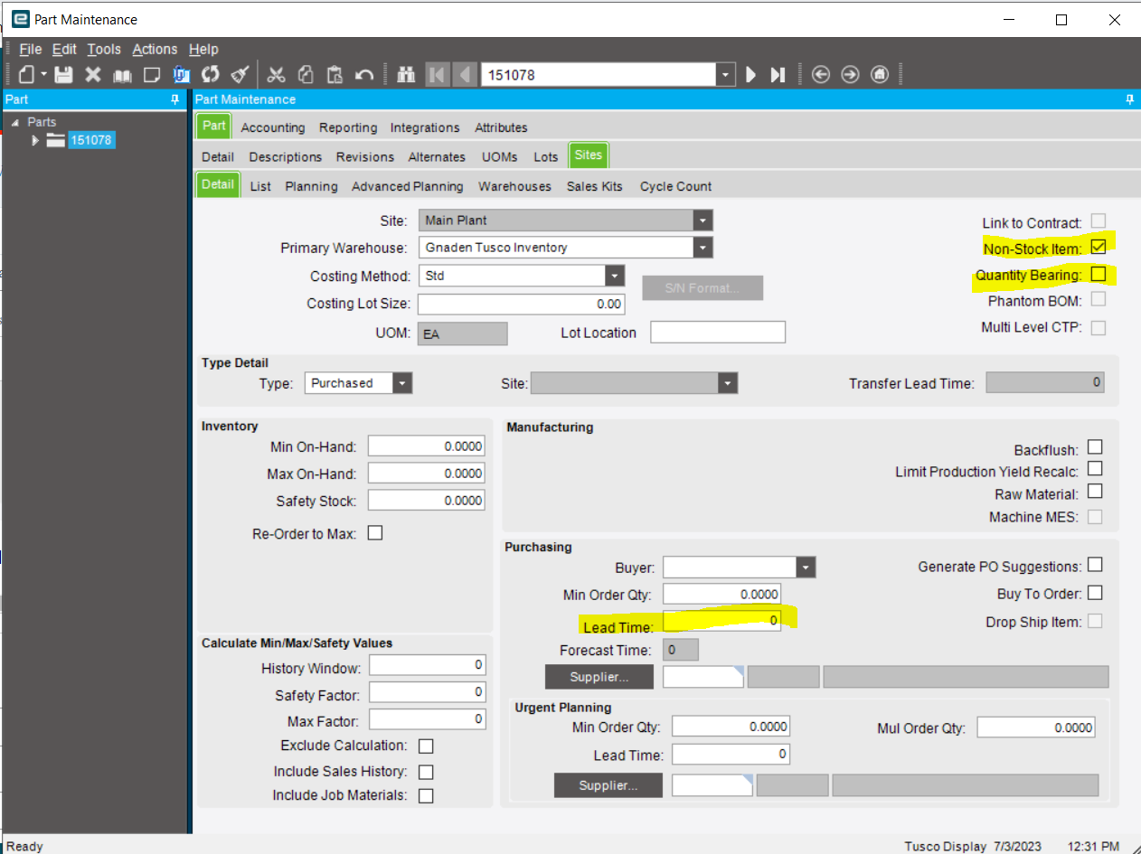

There is no open PO for the stencil (PN# 151078). We already have the stencil on-hand. But since we have the part as not quantity bearing the inventory is showing zero.
The stencil is considered tooling and goes into an expense account. They didn’t want to inventory the stencils so they became marked not quantity bearing. We also don’t backflush the stencils. They are sitting at a 0 quantity all the time. And we have turned off generate PO suggestions.
Thank you for thinking about my issue,
Heide

The stencil is in a part class called Tooling/Fixtures/Stencils and the part class has 0 for default part lead time.
The system thinks we have no stencil available because we have 0 in stock (due to no quantity bearing). The system thinks we have to order it. But we have 0 day lead time. I thought the system wouldn’t bump it out days since the lead time is 0.
The stencil is considered non-stock. I was wondering if this somehow affects it. We also do not have a PO or even PO suggestions for the stencil. And I was wondering if this somehow affects the scheduling.

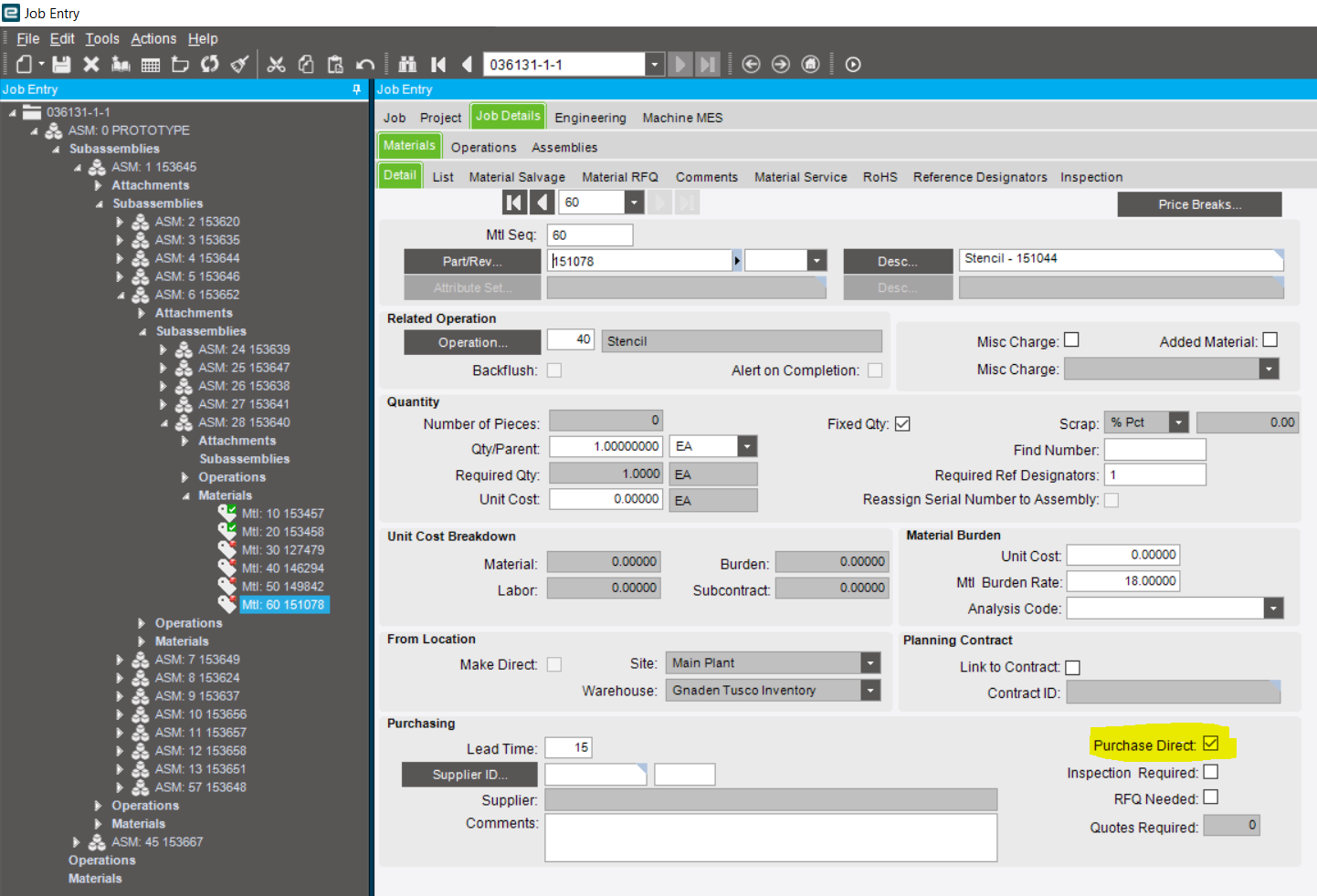

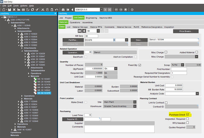

Couple of other things to check. Is the material marked Buy Direct on the Job? Is there a supplier price list for the part?
Hi John,
Most (about 97%) of our purchased parts are buy to stock. But stencils are set as non-stock. You gave a good suggestion to check if the part is “Purchase Direct”. I have never investigated that area of Epicor. Yes, both materials in question are “Purchase Direct”.

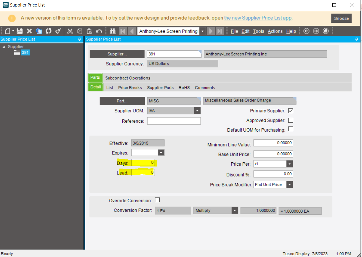

We do not use Supplier Price List. I looked up the supplier on Supplier Price List. There is an entry for MISC but it has 0 for lead.
These two areas are all new to me, can you explain how this impacts scheduling?

Purchase Direct indicates if this material is to be purchased for the Job. I would try unchecking it and see what results you get.
You also use the term “non-stock” in a sense that implies “not quantity bearing”… and these are two distinct terms with completely dissimilar meanings.
On the main Part Entry window, there are two checkboxes, one for each (they also appear at the Part > Site window, as they can be different in different sites).
The Quantity Bearing checkbox (selected by default) means that Epicor is keeping track of inventory quantity. Uncheck the checkbox and Epicor does NOT keep track of inventory quantity (after any transaction, the on-hand value is reset to zero).
The Non Stock checkbox (unselected by default) means that Epicor assumes you want to consume existing inventory before buying/making more. Check the checkbox and Epicor will create buy/make suggestions on every demand for the part, regardless of existing inventory.
If I’m reading this thread correctly, you probably want to have the Quantity Bearing AND Non Stock checkboxes BOTH unselected.
I’m not sure that will fix this particular issue, but it might.
@Heide , look at your screen shot of the material on the job. To the left of the Purchase Direct flag is the lead time which is set to 15. If you zero that out, you should be fine.
Thank you so much. You have found my problem! The Purchase Direct with a lead time of 15 days caused the schedule to be bumped out. When I followed John’s advice @jkane and changed the purchase direct lead time to 0 days that fixed the issue. I also tried Ernie’s and Todd’s solution @Ernie @TDray of making the material have no check marks for non stock and quantity bearing. After saving the material changes, I re-pulled details and scheduled. That also solved my issue.
