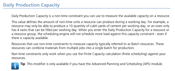

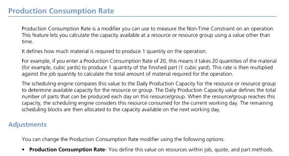

I wonder if a “Daily Production Capacity” (Resource Group) combined with a “Production Consumption Rate” (MOM Operation) might apply?
@bordway - I’m intrigued, but can’t picture what that might look like practically. Are you able to provide a simple setup example?
I would take a look at the scheduling tech ref guide in the E10 Help.
Note that it requires the Advanced Planning & Scheduling module.
And I’m only going guessing… based on a demo I saw once using these, that I “kind of” remember being something like the case you describe.
FWIW, a couple screen shots from the tech ref guide.
