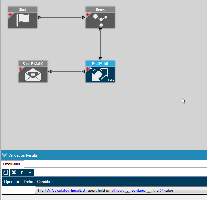

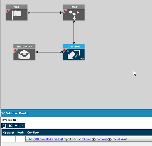

If you’re using APR, you can put in a condition there (like if Company not empty) and send the email only if it’s true. Below is an example I’m using (I have the email address as a calculated field in the BAQ)
