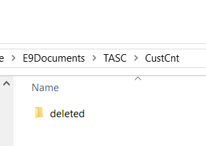

We have the same set up and the files when deleted in Epicor got to the deleted folder in the area it was created. So any attachment placed in Part will go to a folder called deleted in the Part folder.
Unless some accessed the share directly and deleted it there.
