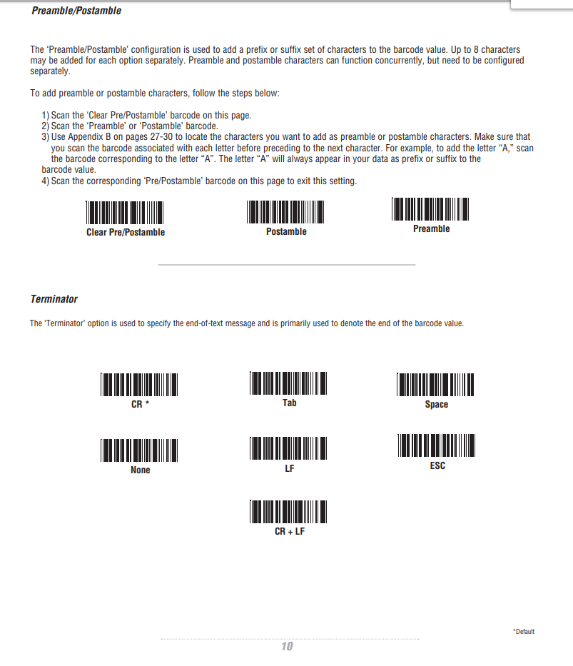

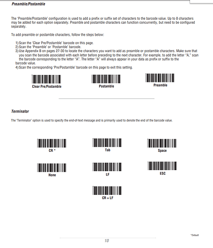

You can embed the tab in the barcode but it is specific to the barcode scanners you are using.
What Model, Manufacturer etc are you using?
Are the tab steps in the correct tab step order? If not, we needed to modify the tab orders to scan in the correct order. You may also need a pause after the job number validation.
If you want to get super fancy, you can start down this road. But it’s not a trivial endeavor.
We are using the WASP WLR8950
Pretty sure the font is DataWorks Bar 39
extremely helpful thanks Joshua!
I think I can take it from here
