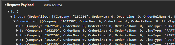

Input: Correct OrderAlloc data

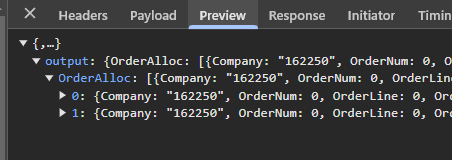

Output: Filtered OrderAlloc data - all the same except only select rows are returned

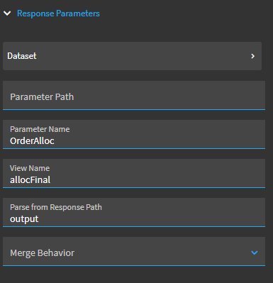

I am attempting to save this into a new dataview called allocFinal. I have tried many combinations and searched forums for assistance without luck and I still can’t seem to get this data to save in a dataview.

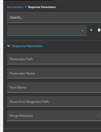

What combinations have you tried?
Maybe something like this:
This has been discussed here before. Looking…
Here is an example:

Confirmed working!
Very much appreciate the assistance.
