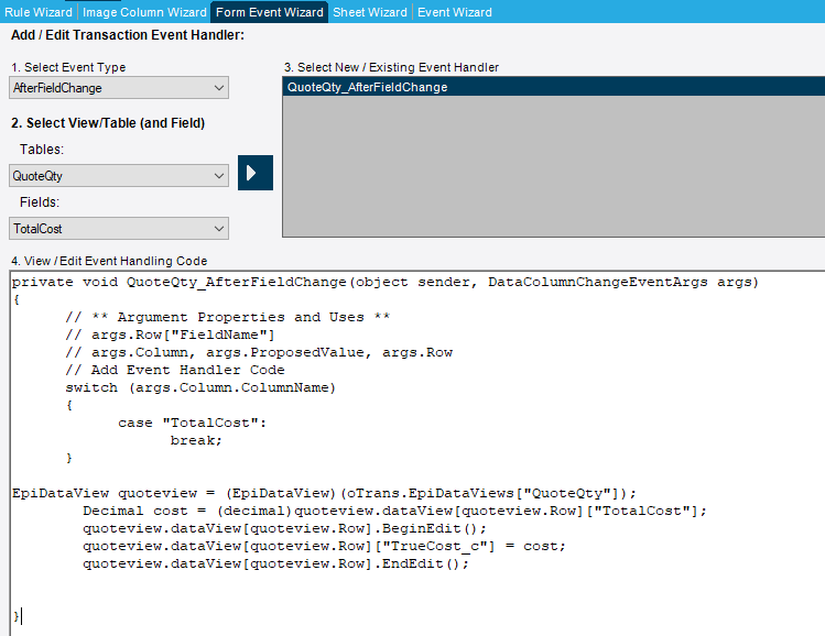

I am working on QuoteQTY calculated fields (TotalCost , TotalLbrCost , TotalBurCost, TotalMtlCost, TotalMtlBurCost, TotalSubCost ). I’ve created a UD column named Truecost_c under QuoteHead table. What I would like to happen is to capture the QuoteQTY TotalCost in my Truedcost_c ud column. I’m now stuck in here. I am not sure if I am using the correct event type, also I think it also might be bcause my UD column is under quotedhead table and not quoteqty? Any help will be very much appreciated.

This is the QuoteQty Customization that I did
	private void quoteQtyGP()
		EpiDataView quoteQtyEdv = (EpiDataView)(oTrans.EpiDataViews["QuoteQty"]);
		DataRow qtyRow = quoteQtyEdv.CurrentDataRow;
		decimal totalCost = Convert.ToDecimal(qtyRow["TotalCost"]);
		decimal totalComCost = Convert.ToDecimal(qtyRow["TotalCommProfit"]);
		qtyRow.BeginEdit();
		qtyRow["TotalCost_c"] = (totalCost + totalComCost);
		qtyRow.EndEdit();
		this.oTrans.Update();
		this.oTrans.Refresh();
	RefreshBAQDataView(quoteGPBAQDV);
