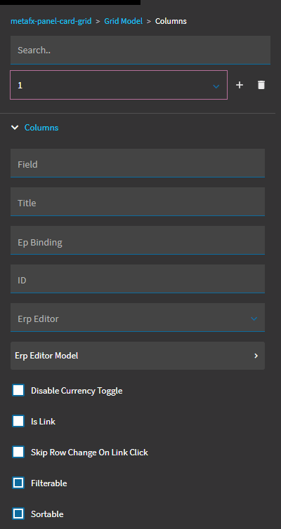

I got it working for me. Keep in mind that im still learning Kinetic and probably doing something wrong.
But i guess we have similar setup in our dashboards. What i did i accidentaly added a column, didnt fill any fields there. After publishing it it instanty displayed my saved personalizations correct. Had to do this for both of the grids i had in my dashboard.
So without any defined columns in app studio, it doesn’t work?
