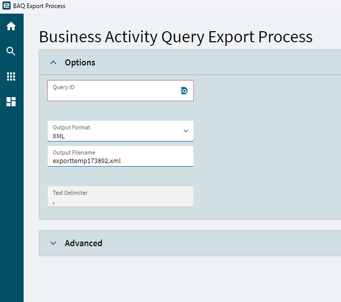

You can use the BAQ Export Process (as others has mentioned)
Then in the Output Filename path enter in the UNC path to the shared Epicor Cloud FTP site that was given to you with the filename.
Then in Schedule enter in the task schedule you created to run in the background (hourly, daily, etc).

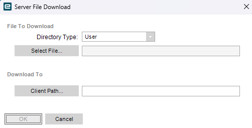

You can also drop it in the folders that can be reached via Server File Download.
