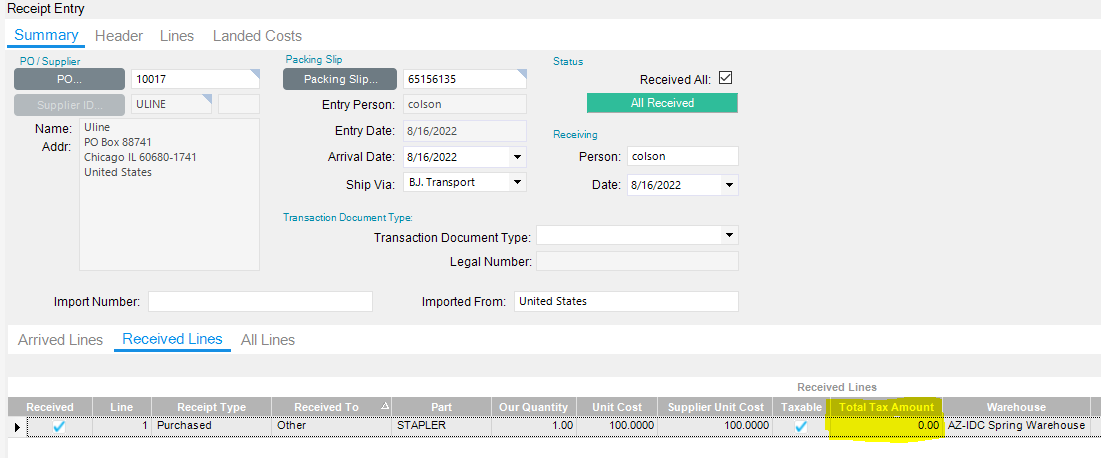

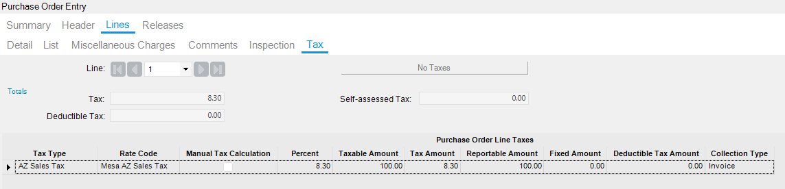

Our company often places purchase orders for non-stock items that are taxable, such as office supplies. For example, a buyer will place a PO for $100, and will put sales tax of $8.30 on the PO Line Release.

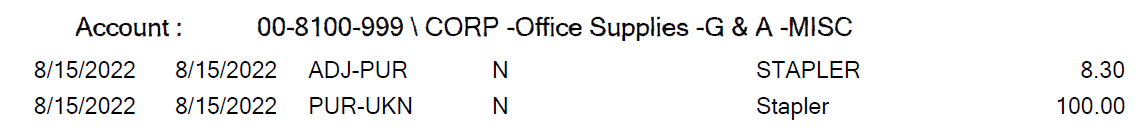

When we then enter the AP Invoice for the PO lines, again, the sales tax amount is now following the line so, we manually add a New Line Tax Code on the invoice lines, and it creates a ADJ-PUR which puts the sales tax amount to the same GL account as the PO Release.
This appears to be working, but here is the issue: Our AP accountant has to add a New Line Tax Code for every taxable line that we invoice. It seems very burdensome and redundant to manually add a line tax on the AP Invoice when this was already completed on the PO Release.
Shouldn’t the tax amount follow the PO Line all the way through the receipt and invoice entry? Is there a better way to handle this?
