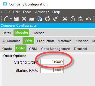

We are getting close to going live but not there yet so this is a (mostly) empty database I am working in and testing. I am trying to set the starting number for new sales orders. We would like to start from 210000 next year so that is what I set the number generator for in Company Config:

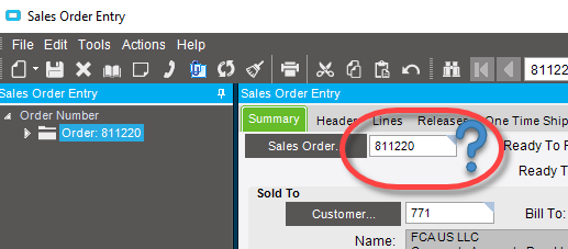

But when I create a new order it assigns a number of 811220:
Now, I did previously create a couple test orders in the 800000 range but deleted them. So they are not in there but the number generator seems to think they are still there.

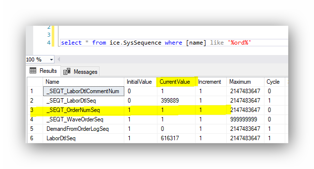

There are two tables Epicor uses to store current sequences so that it doesn’t have to read large tables to get the next available ID. The two tables I know of are ICE.SysSequence and ICE.SysBigSequence. I looked in ICE.SysSequence and there is an entry for OrderNum, but in my database it’s set to 1. Maybe see if you can query against this table to see what that sequence value is set to. You would probably need a data fix from support to reset this.
OK, looked at that. Nothing in there like ‘order’ anywhere and no other entries look like they fit. My DB doesn’t have the ‘_SEQT_OrderNumSeq’ row. We are on 10.2.700.3

To get a new Starting Order Number go to Company Configuration>Modules>Sales>Order.
There is a field called Starting Order. Enter the number you want there.
Vinay Kamboj
I tried that, it doesn’t work. It always remembers the highest number ever entered.
thanks
You have to give a number higher than that.
