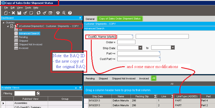

Did you also make a copy of the underlying BAQ and swap that out in your new dashboard?
Bruce,
Yes, I made a copy of both. My problem is that I can not make changes on the copy. Can you make changes on the copies?
Thanks,
Yes, I can change both…
only thing to remember is to tie the Dashboard copy - to the BAQ copy.
otherwise the dashboard copy will “remember” the original BAQ
