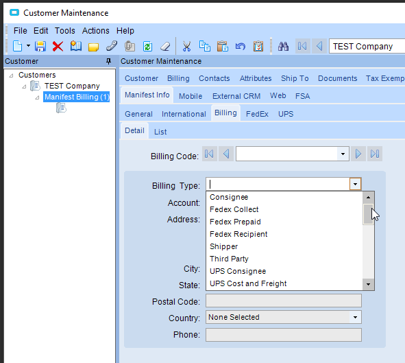

We tried going into Customer Maintenance and seeing if there is a way to “default” a ship billing account, and we have had zero success.

You CAN store the account numbers in the Manifest Customer and Manifest Ship-To Billing tab. It’s meant for the Manifest product but you should be able to pull the records from the sales order which come from these tables if I recall correctly. If not, a Method Directive should do the trick.
