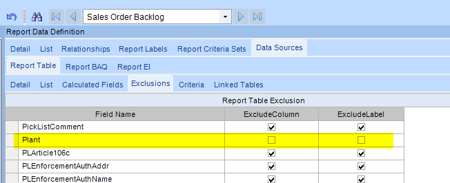

Under Order Management–>Reports, there’s the Sales order backlog report. When I select output as CSV, it create a CSV file. I would like to add “Plant” to this output. Anyone know how I can do this? The Report Style is SOBacklog, but doesn’t seem like modifying this does anything when I am out putting to CSV.

I had already copied the RDD and add in plant since that is already available within the “OrderHed” table. I can add this to the SOBacklog SSRS report and it print fine. However, if I change the format from PDF or Excel to CSV, it does not show up. My questions is, where do I go about adding this “Plant” field so that it print when changing the format to CSV?
So this “Plant” field is already available within the RDD.
I had added the “Plant” to the SSRS, but will not print when I change output format to “CSV”.
In order to output data to a CSV file, you have to include the data in the output from the SSRS report - so it would show up if you ran the output to PDF or Word or any of the other supported types. Seems like you have already added the data to the RDD (although if available, a linked field may be easier) so now all you need to do is add the data to the SSRS RDL. See the following link for more information on how SSRS renders to a CSV file.
