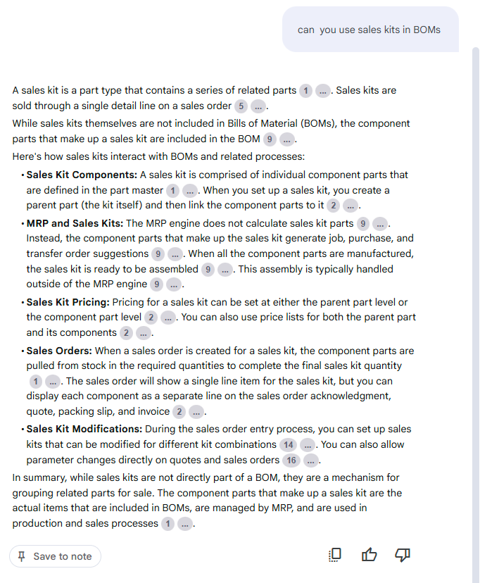

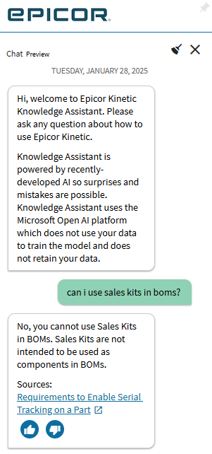

I have it from this TOP-LEVEL AUTHORITY that Sales Kits are NOT allowed in BOMs, yet Kinetic allowed a user to add sales kits in a BOM.

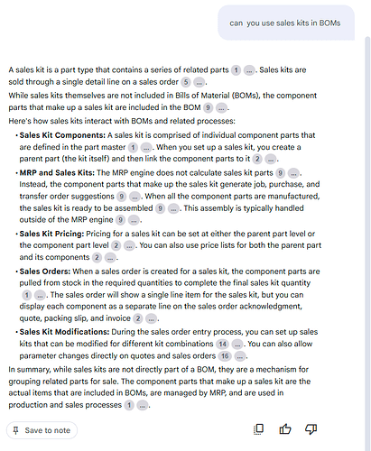

Here’s another take
Where is that from?
Notebook lm
