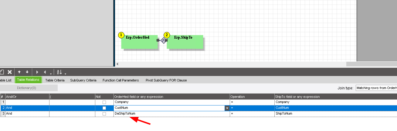

On the link with the ShipTo table be sure you have both the customer number and the ship to number linked.

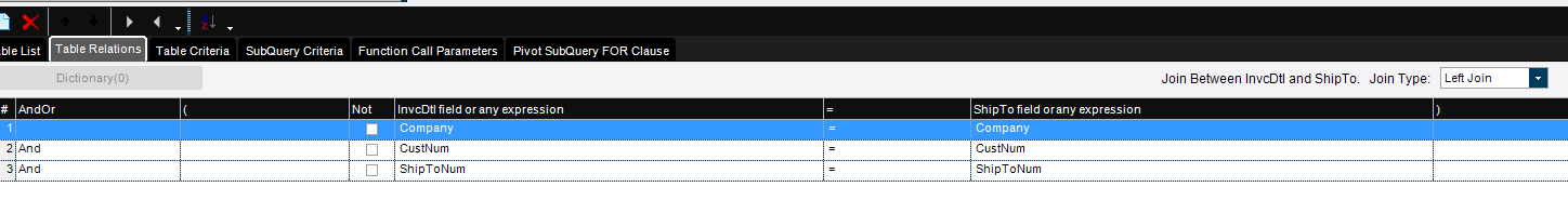

Here’s what I have the join set to -
Also here’s my query so far - (tons of duplicate rows for each invoice/pack…) -
