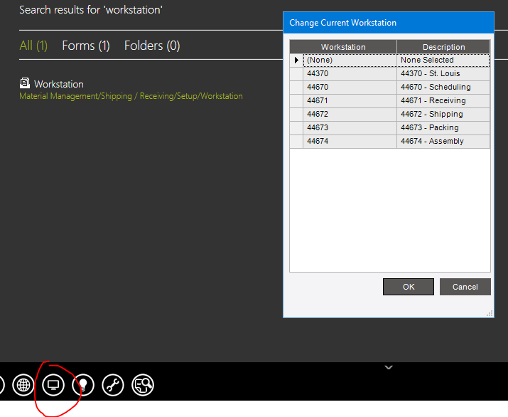

But all that aside… Under Printer Maintenance you would setup your Paper and Label Printer if I recall and then you can assign it to a Workstation, under Workstation.
The User then can switch Workstations, or you can assign the user a Workstation in User Security Maintenance.
