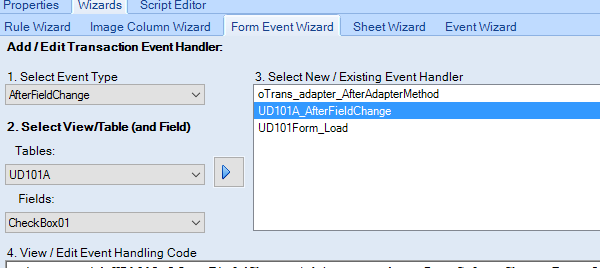

For posterity
  1. Open Customization
  2. Click Form Event Wizard Pane
  3. Select Event Type After Field Change
  4. Select Table (in this instance UD101A)
  5. Select the Field you want to test that changes
  6. Click the arrow button.
  7. Repeat for any other fields you want to test.
  8. Add the code as Jose mentioned to each test. Comments are pretty self explanatory about the arguments.
    args.ProposedValue is the value the field will be changed to. args.Row[“Fieldname”] is the field you want to affect on in the test.Eg.
private void UD101A_AfterFieldChange(object sender, DataColumnChangeEventArgs args)
// args.Row[“FieldName”]
// Add Event Handler Code
	case "CheckBox01":
		if((bool)args.ProposedValue)
				args.Row["Checkbox02"] = false;
		break;
	case "CheckBox02":
				args.Row["Checkbox01"] = false;
		break;
  1. Click on the Update Selecte Event Code
  2. click on the Script Editor tab and press F5 to confirm that the code will compile cleanly.
