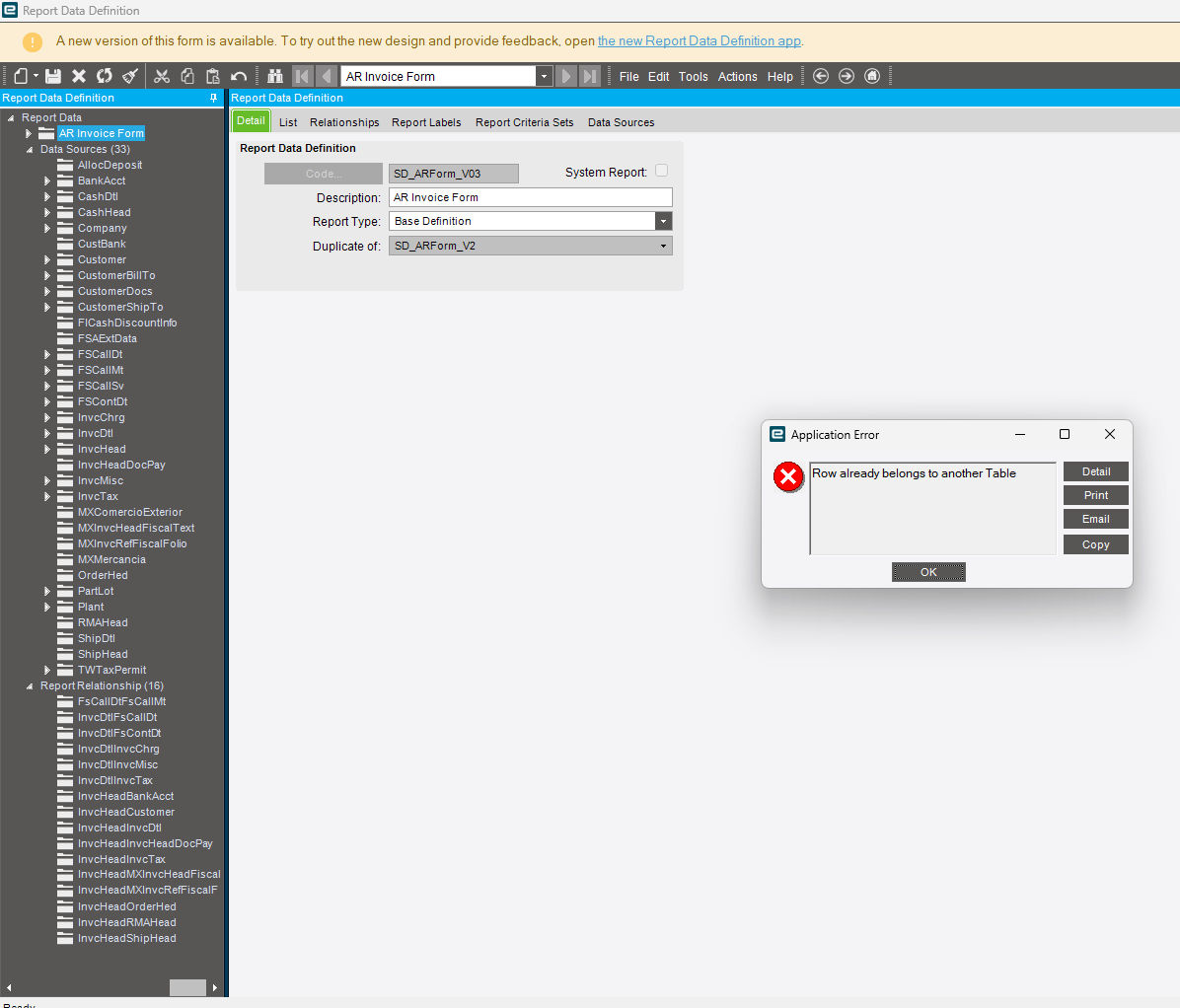

Need some advise on ssrs reporting, after the update from epicor, my AR Form customize report are unable to generate, before the update can generate normally, so when I checked the RDD is shows this error
issue is error between invcHead and OrderHed.
Appreciate your help on this!

I’m running into this also. And I took the steps of trying to recreate the RDD from the base version and the issue presents itself the second I try to create a relationship with InvcDtl and OrderHed. It appears to be an impasse for right now.
One “workaround” that I’m tinkering with is you can still create a new relationship in the application and then using a UBAQ, you can add the relationship fields and it seems to accept them that way. But there were so many fields that disappeared I am still working on trying to clean up the RDL and match it with the new RDD created from the new base report.
I tried link with the ARInvoice but still showed error “row already belongs to another table” I told the finance team use to original report 1st until I can solve this custom report

I’ve also added OrderHed to InvcHead and I DO NOT get an error when I open my RDD. Perhaps we slowly compare yours and mine and see if we spot any differences that may be a concern??
Hi @dcamlin my SD_ARForm_V2 is not linked yet with OrderHed yet, so when i tried to link it it shows the same error
It’s a bug - its supposed to be fixed in 2024.1.8
Thanks, I’ve been messing with this on and off all day. Glad I found this!
Not fixed as of this morning… testing 2024.1.8… still get this error. :angry:
At this point working with RDD’s is crippled until they fix this.
Anybody else have any luck?
The PRB says “in release planning”
