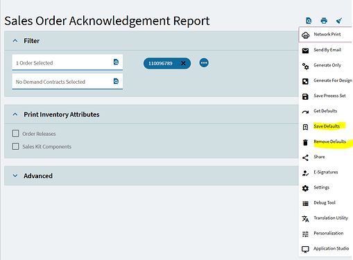

SOA has an order select when you click print…is it somehow saved as a default? If so, remove…

Restore Defaults did the trick!!!
