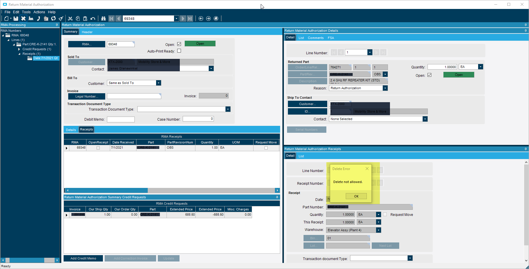

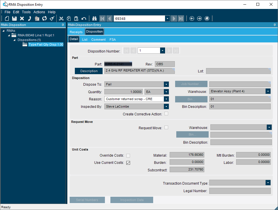

We have an RMA that we have created a disposition for.

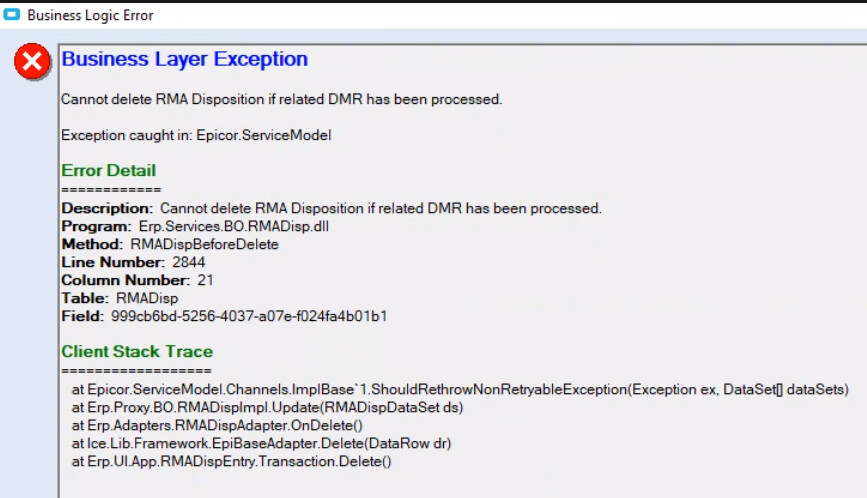

When trying to delete the disposition we are getting an error
This makes sense, but when I go back to the RMA processing to try to delete the receipt I cannot
Are there suggestions on how to change this RMA?
Has there been an invoice created against that RMA?
You will have to back out the DMR. Not sure if you can, but open it back up and try to undo it.
There is a credit memo for the RMA. That is the receipt that I cannot back out. I am getting the generic message ‘Delete Not Allowed’
If the credit memo isn’t posted yet, I think deleting it should allow editing the RMA. But if it’s posted, I’m not sure what your options are. You could try creating a “cancellation invoice” for the credit memo (under Actions menu in Invoice Entry), and then reissue a credit memo after editing the RMA if needed. Probably good to try that in a test environment first.
