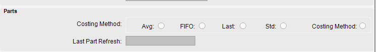

Note: this not suitable if your cost system set as last, or average unless you customize your reports and cost rollup to exclude these batches, but standard method will work ok.
