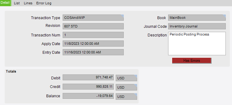

Hello,
We have a problem.
We have a review journal with a negative balance.
We tried cancelling and reposting but it isn’t fixing the issue.

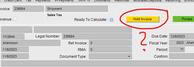

We invoiced it on the 10th… but it has a yellow “Hold Invoice” that actually isn’t checked off.

Sounds like there might be a missing GL Control Code. I would dig into whatever GL Control Codes are involved to see if there is not a GL account.
Rejecting and submitting will not fix the issue. You need to track down what the error is and address it. You could also use the PE Log to try and figure out what is wrong.

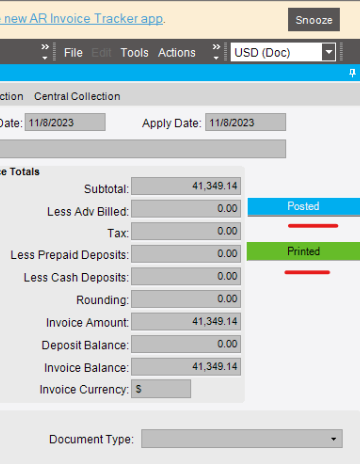

It looks like the review journal transaction is coming from the Capture COS/WIP process, not from Invoice Entry. That AR Invoice you show looks like it posted correctly - I would expect to see “Review Journal” as a status if it were the transaction that were stuck.
I suggest cancelling the review journal and then running the Inventory/WIP reconciliation report for 11/8 (the apply date) to see if the GL summary balances. You most likely have a missing GL Control code.
