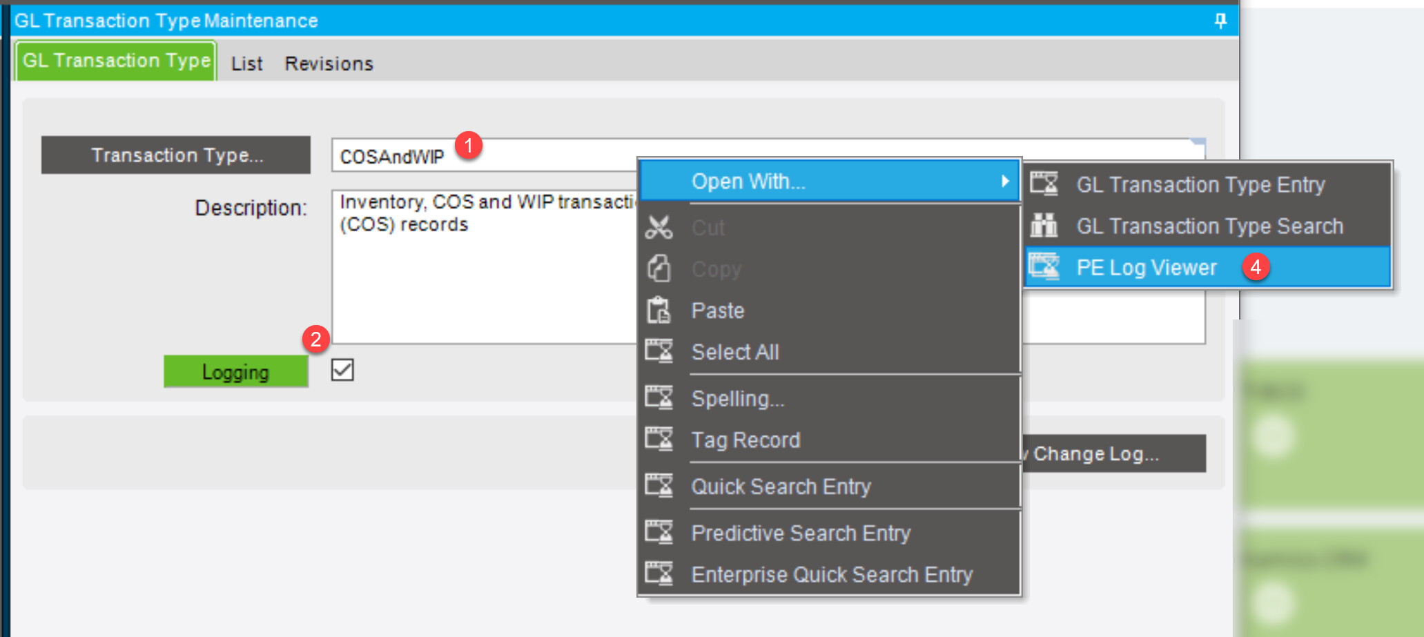

To find where the error is occurring
  1. Open GL Transaction Type COSandWIP
  2. Turn on Logging (don’t leave this on)
  3. Run inventory WIP recon report filtered to the transaction type and date
  4. Go back to GL transaction type and right click on the COSandWIP to open PE Log viewer to review where the error occurred.
