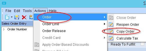

  4. Create new Order - note that this is easier with the Copy
