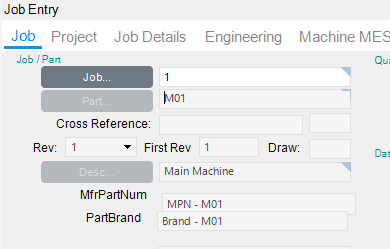

Hi, Recently I’m implementing additional field which is manufacturer part number. At first everything’s fine, I can create a UD field in Part_UD after that save some value to it and retrieved it on Job Entry using this:
Blockquote
private void QuoteDtl_AfterFieldChange(object sender, DataColumnChangeEventArgs args)
// args.Row[“FieldName”]
// Add Event Handler Code
case “PartNum”:
PartAdapter adpPart = new PartAdapter(this.oTrans);
adpPart.BOConnect();
adpPart.GetByID(Convert.ToString(args.ProposedValue));
        string MfrPartNum_c = Convert.ToString(adpPart.PartData.Tables["Part"].Rows[0]["MfrPartNum_c"]);
		string PartBrand_c = Convert.ToString(adpPart.PartData.Tables["Part"].Rows[0]["PartBrand_c"]);
        args.Row["MfrPartNum_c"] = MfrPartNum_c;
		args.Row["PartBrand_c"] = PartBrand_c;
        adpPart.Dispose();
	break;

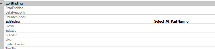

When face the obstacles when comes to a form that’s build up by non-database table which is issues material form.
  1. So first think I did is to create a field for binding purposes
    ((EpiDataView)oTrans.EpiDataViews[“Select”]).dataView.Table.Columns.Add(“MfrPartNum_c”, typeof(String));

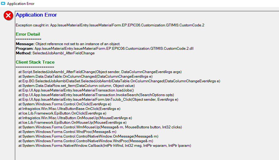

After that, when I try run, this error message prompted out,
Anyone has any idea on this?
Thank you!
Hey Guys, I’ve found the solution.
