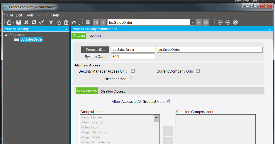

Process security maintenance will give you direct control over access to all business objects and methods.
Edit: If you have modeled security using menu and process securities through menu maintenance only, when switching to REST, you’ll want to map out current security roles from menu items and extend the roles to the object securities. Any REST user should hit similar security restrictions inside or outside of the application.
