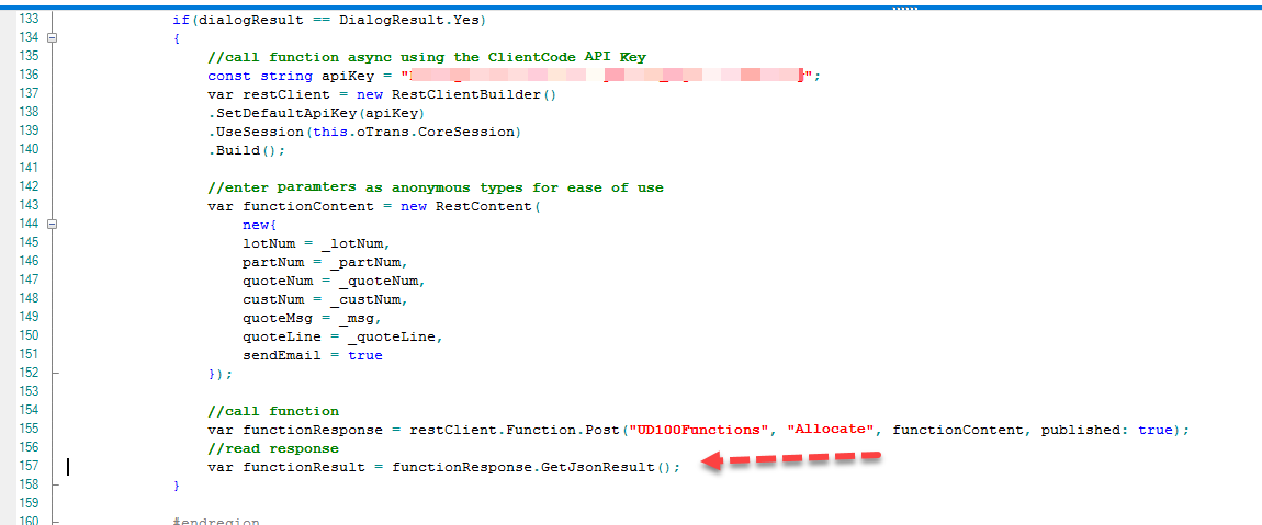

I am following along in the Ice User tools guide for 10.2.600 and I am trying to handle the response using the following code:
var functionResult = functionResponse.GetJsonResult();
I already added the Ice.Lib.RestClient assembly and all compiles just fine until I get to the above code.
The error is stating I am missing Newtonsoft.Json.Linq.JObject, which I assume should be included in the Ice.Lib.RestClient library.
Compiling Custom Code ...
----------errors and warnings------------
 Error: CS0012 - line 157 (344) - The type 'Newtonsoft.Json.Linq.JObject' is defined in an assembly that is not referenced. You must add a reference to assembly 'Newtonsoft.Json, Version=12.0.0.0, Culture=neutral, PublicKeyToken=30ad4fe6b2a6aeed'.
 ** Compile Failed. **
I don’t have a problem adding it manually, but it didn’t look like it needed to be according to the guide. Anyone else getting this?

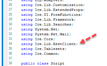

It a separate library from RestClient. Check out Mr Shoemaker,s post, especially the using statements. The library ships with Epicor, no install required if working within Epicor.
Sorry I thought it was clear from the screenshots, but this is working within Epicor in a client customization and I was simply following along with the example in the User Guide.
I added the reference to the Ice.Lib.RestClient library, but it still requires an additional library (Newtonsoft.Json) to be added manually in order to work.
I would have assumed that since RestClient is a client library already, it would include any dependencies (in this case Newtonsoft.Json) to work, but that’s not what I am finding.
Edit: It looks like it ships with it, but one does need to add their own using statement to it
